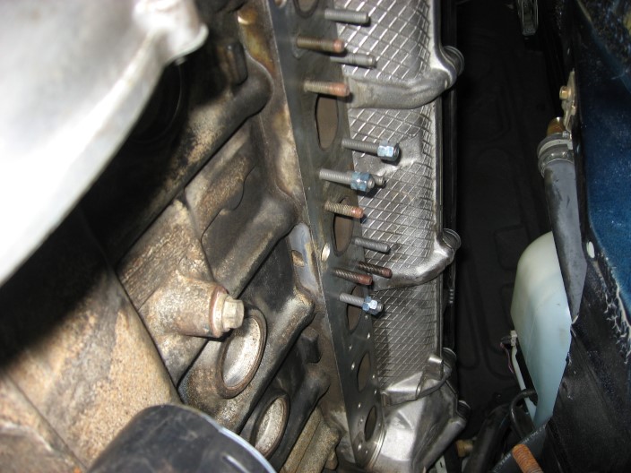

                  You are right to consider replacing the exhaust studs. They only cost about .32 each from the dealer. I replaced the copper nuts as well.
                  As in Freds experience, most of mine came out when I removed the nuts, so I only replaced those. Big Mistake!
                  Getting the nuts started on the partially rusted studs took a lot longer than getting them started on the new studs.
                  Be aware though. The studs are fine threaded and they screw into the block pretty far. If the engine is in the car, it gets tiring so I started them by hand, then ran them in with an air ratchet with the torque turned way down and finished tightening them by hand. Much faster and less tiring.
                  To install the new ones, I just double nutted them as seen below.
                    Yes, this is one of those tips and tricks that I learned from my first swap. Install the studs when the engine is on a stand. Installing them lying on your back underneath the car, or your hand snaked in some awkward position from up top is not fun.

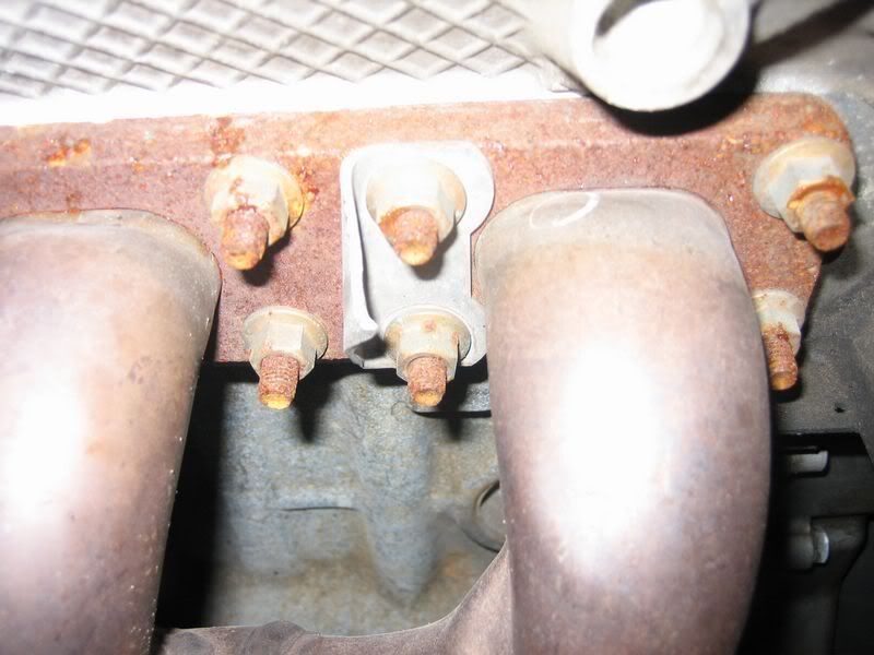

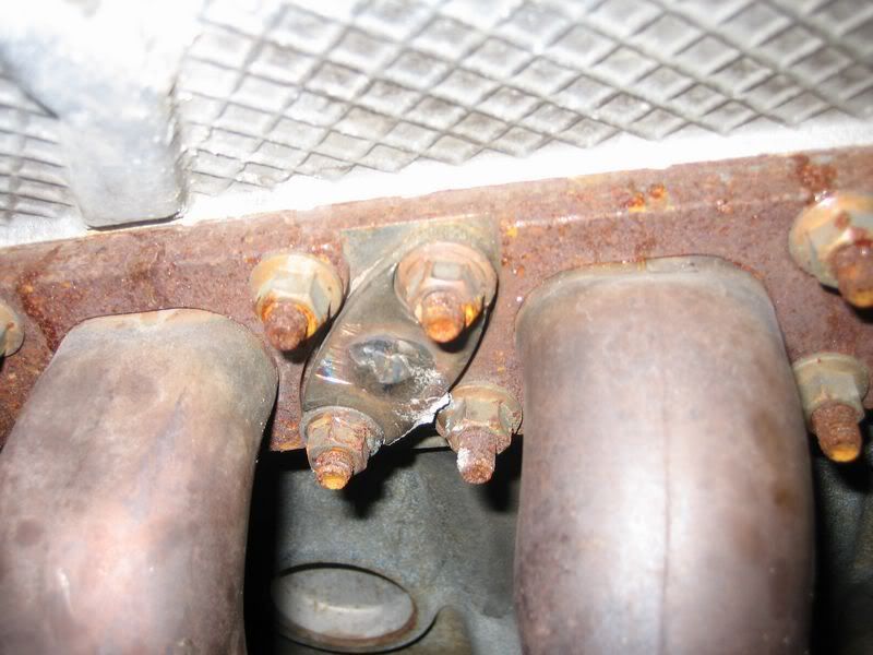

                        First I busted off the air pump by wiggling it back and fourth until it snapped off. That way you don't have to break the exhaust seal.
                        Then I took it to my machinist to cut the tabs off and weld them shut, then I bolted them back down.
                        Rollin' with a Geistkuchen
                          That is what i did. Have you had any problems?
