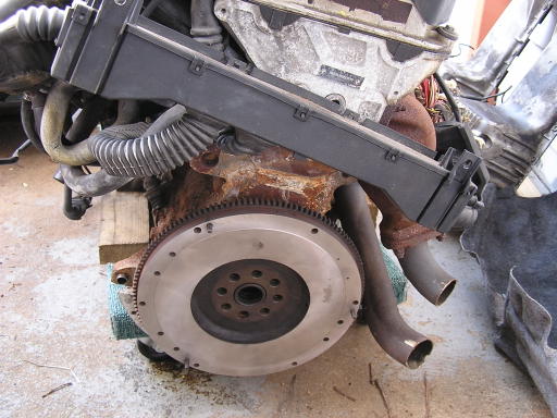

    I've got my S52 in my car and wired up. The trouble is that the motor is locked up. I know the motor turned freely when I purchased it and checked it prior to tossing it in the car. I used the Getrag 260 with the e30 clutch flywheel and starter. I'm guessing that there is some issue with the clutch/flywheel combo or possibly a bad starter. Another suggestion I've heard is that I might have to grind part of my oil pan as has been discussed in a few threads on here. I don't THINK that's the case but I'm not 100% sure. I need to tear into the vehicle and confim things but I was looking for any suggestions I might not have thought of.

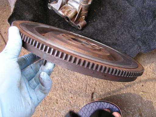

      The back of your flywheel is hitting your oilpan/engine block.
      In order to use the e30 single mass flywheel on an s52, you are supposed to have the backside of the flywheel machined down for clearance.

          Yeah,thats probably your problem. Some machine shops won't take off enough material though, so its easy enough to grind down some of the casting on the oil pan.
