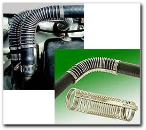

            i too bent the heater tubing almost leveled or straight forward,i used the spark plug wrench in the tool kit and it fit over the tubes perfectly w/o damaging.
            then,i used a unicoil heater hose bender,it would bend the rubber heater hose even pass 90 degress w/o kinking-got it at advance auto in the radiator hose repair section....

              I got the hose on all the way but the IM is all up in its business and kinks the hose. I will check out the unicoil if i need it.
