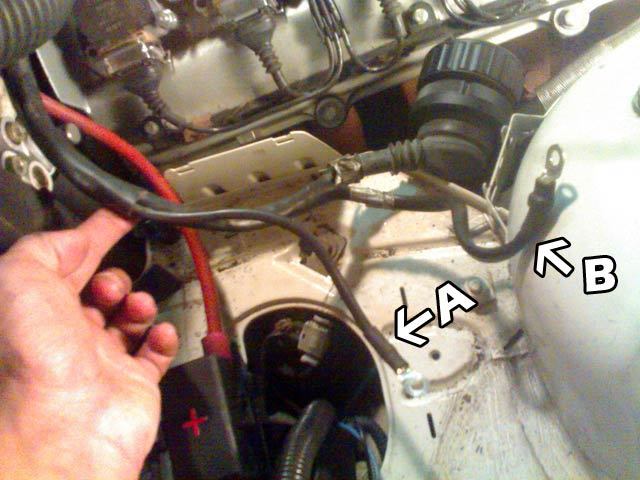

          This is a photo FredK posted for me when I was having trouble getting mine to start. Did you make the wiring adapter or buy the one from Treehouse?
          In this pic the thicker wire labled B is ground, A is 12v+

            Hmm I'll look at my wiring when I get home.

              That was it, I hooked that up and bam! it started. Not even a hesitation, it just went.
