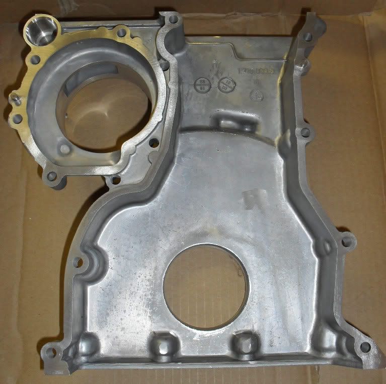

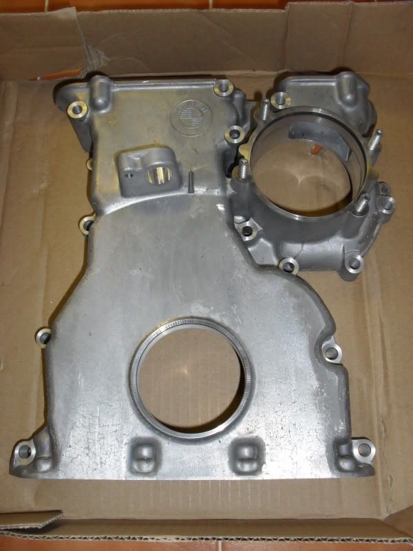

Yes you can.
There are 4? bolts semi hidden under the cam sprockets going through the head and down into the upper timing cover that you will need a wobble extension or two two get at.
They are external torx head bolts, make sure you get all of them before you try prying the upper timing cover away from the bottom of the head or you will encounter alot of resistance i.e. it won't fucking come off!
I used some red permatex RTV on the top of the timing cover on reassembly since the only gasket sealing it at the top is part of the head gasket and cannot be replaced on its own.
EDIT: The e36 Bentley manual says that the crank hub bolt is one time use. I went to order one from the dealership and they had never ordered one in before, spoke with a tech there and he said that they always re-use them just put a bit of loc-tite on it. I waited for a long time for a stupid new bolt to come in before I found this out.

by looking at those pics, i don't see 4 bolts that would go through the cover from the head?1993 325ic Schwarz/Natur
