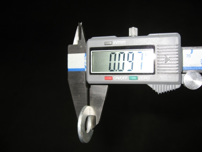

How much shim are you running under your motor?

    dont shim it... it fits with the e36 arms and green mouns without shims

      i am running Ebay Headers, e36 arms, and Gray E28 motor mounts(same shape as the greens, but grey?). engine is going in this weekend, i will update if i have to use shims.

            I only needed one washer for a shim with ebay headers, e36 arms and green M5 motor mounts. With stock s50 manifolds, I had no shims.
            • static
              • Oct 2005
              • 501
              my mechanic put a 1/4" thick shim under driver side to clear the ix booster. running stock obd1 manis. Is it really that bad to shim only one side? 1/4" is also pretty substantial by your standards guys.
              the booster is only 2-3mm away from the shaved mani, so this shim is needed
              oh and i am using the e34 m5 mounts (black cylindrical)

                Hm. I am SHIM CITY on my 318is, running OBD-I manifolds and midpipe and a 944 booster. There's probably 3/8" of washers on both sides to clear the booster and midpipe.
                I'm using 2 Meyle brand 535i mounts. Trapezoidal-ish in shape.
                • cheades
                  • 632
                  1/4" of spacer on each side, using the hockey puck M5 motor mounts.

                    Originally posted by gazellebeigem3
                    Im using a 1/4 inch with obd2 manifolds and midpipes. (w/standard green mounts and e36 arms)
                    same setup here, with some intake manifold ribs ground down.
                      Forgot to mention that I had to trim a few manifold fins too.

                        So as an update, since I dropped my motor in last week, I'm thinking I'll be fine without shim since I chose to bend my Ebay header rather than add a shim plate.
                        As it fit without bending, my front header (turns into the inner downtube) was hitting my subframe, so I put the floorjack under it, jacked it into the unibody & let it sit for 20 minutes, then released tension. The result was that I now clear my subframe by a generous 3/16", and now the tail end of the pipes sit parallel.
                        I had to bend downward my upper heater core hardpipe about 3/8" to get out of the OBD1 intake, but other than that I don't see a spot that will cause me any issues.

                          Green "bell pepper" E28 mounts, E36 arms (both sides)
                          Shaved last 2 manifold fins (they were not hitting, but they were too close)
                          eBay OBD2 replica exhaust manifolds w/ dimpled & modified OBD1 downpipes/cat
                          No shimming. The fit is a little tight with the exhaust, but it does not rub.
