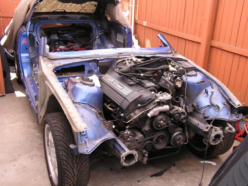

this is my next set up on my e30m3 s52 swap:"
ix booster,540 mc and remote reservoir:
my donor:
i feel like an e36m3 butcher:-(Comment
