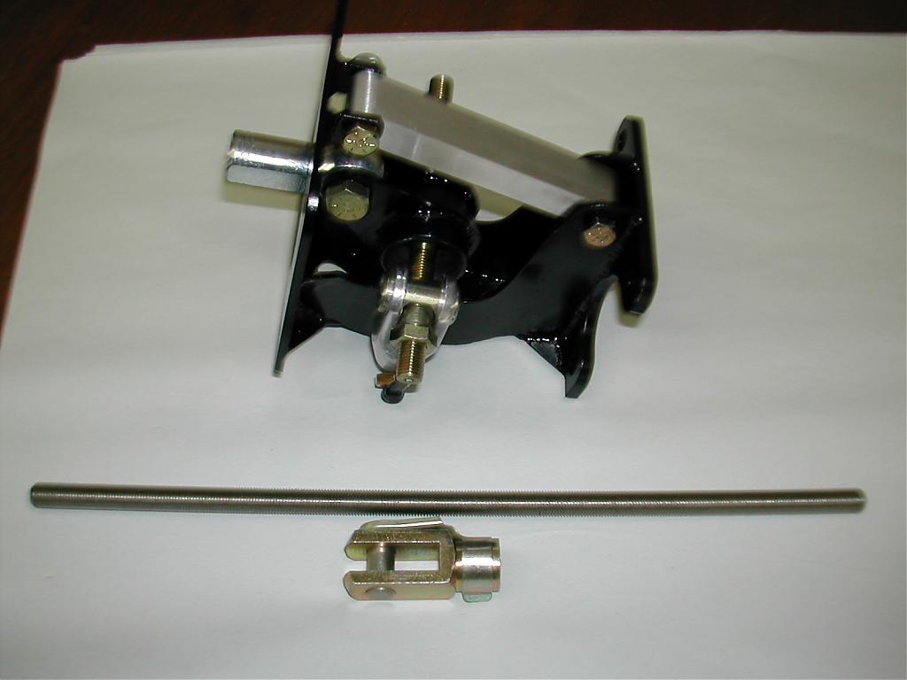

                      I am creating a bracket that will allow the use of dual master cylinders / adjustable bias knob, that will work with the stock pedal cluster. If you forward the specs of your car/brake system to Tilton, they will spec master cylinders specific to your application.
                      I created this bracket to deal with the intake/booster clearance issues associated with a Euro swap, but it will work well in other applications.
                      I should have the prototype in my hands for test fitting this weekend.

                        mike b, will this work with floor mounted tiltons, or firewall hung tiltons, or both?
                        Do you delete the ABS if you run manual brakes?
                        • Mike B.
                          • Jan 2006
                          • 987
                          The bracket is designed to work with the stock pedal cluster.
                          I am deleting the ABS with my setup. I don't think you can run lines from the dual masters to the ABS pump, but I could be wrong. Anybody have any input?
