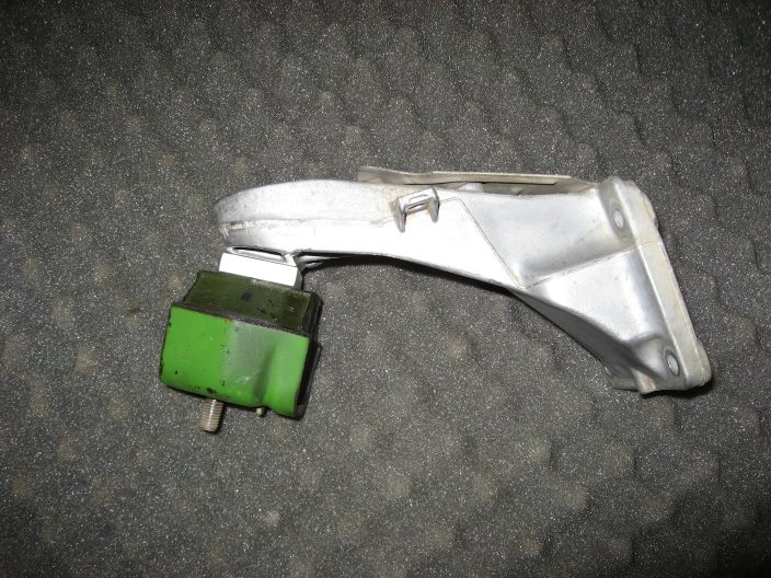

                              Picture shows orientation. The spacer is the one provided with ebay headers (didn't need to use it).
                              No redrilling or grinding of nubs and the mounts fit perfectly.
