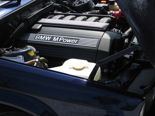

        +1 $5,000 will get you started but plan to spend at least $7-8,000 (more if you plan on modding).
        I LOVE my S52 swap. The power is unreal in the e30, and with all new gaskets, sensors, etc. it runs almost like a new car.
        My engine mods include 3.5" MAF, 24lb injectors, UUC flywheel & clutch, Riot Racing throttle body, CAI, Stromung exhaust, full OBD-1 conversion and of course a Turner chip for the above.
