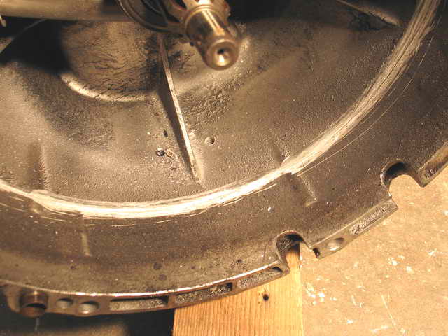

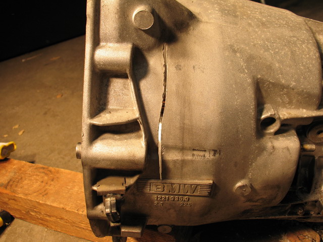

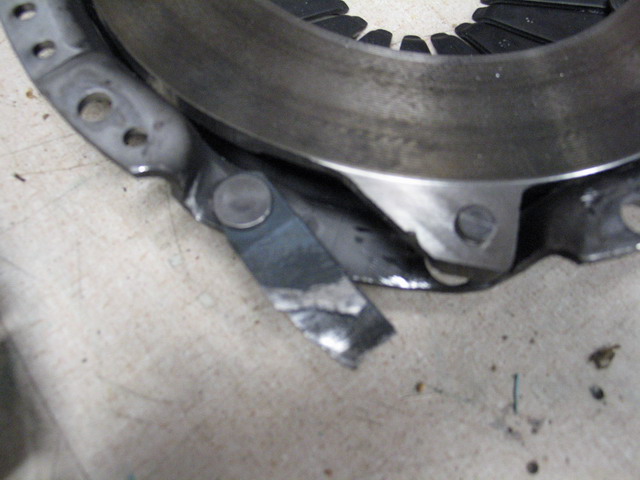

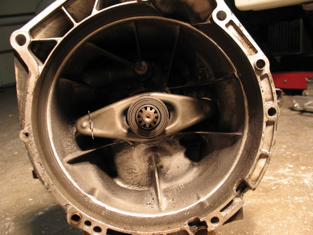

                        #41
                        Here are the pictures:

                          #42
                          I called it. What did I win? lol

                            #43
                            Ok. As expected, it was a major pain getting the trans out.
                            Some details on tranny removal:
                            I removed the exhaust + headers (can't quite get the downpipes out without taking the headers with them). I also took off the intake manifold - can't see how you can get at the starter bolts without doing this. Next, I drained and removed the radiator. I used an engine hoist to life the motor off the mounts which gave me lots of room to see and remove the bitch bolts.
                            So, a few of us guessed at the failure - a broken pressure plate strap which swung out and did a really nice job of machine the transmission. Now, I have to figure out what to do next.
                            First, is the trans salvageable? The cut it pretty long. Right now I'm thinking I can have this welded up - including extra welding at other areas where the metal might be thin. Maybe welding on the outside instead of inside. Any thoughts on this?? There are thin areas beyond the actual cut, but most of the circumference is a scrape instead of a cut.
                            Secondly, what clutch setup should I go with next?? The e30 325i flywheel and clutch look mint. Well, there really is only a couple thousand miles on them.. The easiest thing to do is to slap in a new pressure plate in and bolt it back together. But, could this happen again? I believe there are plenty of people using the e30 clutch setup without problems and I'm not sure the strapping on the e36 pressure plate is much beefier. Would a e36 lightweight flywheel and clutch be a better bet? Cost difference is going to be between $70 for a new pp or much more for a whole new e36 flywheel/clutch/pp.
                            The pp in there was a Sachs. Someone commented that the failure could happen from bad downshifts. I'm well versed in heal-toe, but I did miss a few from break fade. Also, during the track event I had a few grinds during upshifts (4th to 5th) and general upshifts seemed nothchy and not very smooth. Maybe the clutch was not fully releasing or the sychos are worn, and/or I was low on tranny fluid. My car was smoking a lot after I got off the track and I couldn't quite track down the leak (much of the underside of the car and cat was coated with oil). Maybe it was the trans losing fluid, but I was thinking more likely to be the dip stick grommet. Maybe the nothcy and hard upshifts caused the strap to break. It happened right after a 3-4 upshift.
                            I've got several things to consider there. Advise anyone? :shock:

                              #44
                              Originally posted by E30 Groupie
                              Using the stock m20 clutch and pressure plate can and will break those bands easily. A few people up here have had the bands doubled up, even on the m5 setups to eliminate that weak point.
                              Found your previous post... So, you're saying this has happened before with the m20 clutch. Therefore, my best bet is to run far far away from the m20 setup? I'll gladly ante up for a e36 setup if there's some certainty around this not happening again.
                              I'm not sure you win anything here. :ohsnap: But, a grateful thanks on how to fix it up to make sure this won't happen again.
                              • Van Westervelt
                                • 9365
                                #45
                                Different shops can put more bands on and double them up for you so its not an issue. er, less likely :)
