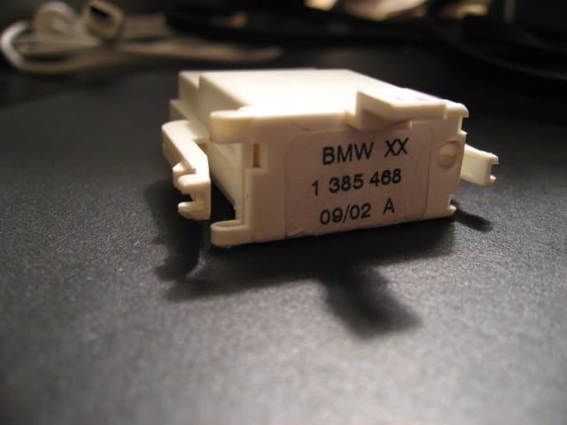

                        I'm not sure what is your trouble - hope you figure out a solution!
                        Here's a pic of mine - it's a standard '468 plug, just from late-late E30 production.
