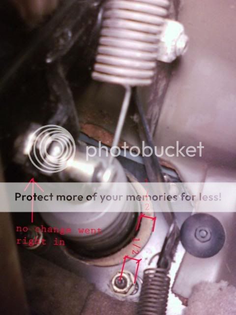

                I used stock booster and res. e34 motormounts and have 1/4 inch clearance and pedal box does not move over my fork went right in.

                  I'm thinking that might put a little more side-load onto the booster than you want, when you depress the brake pedal, leading to a shortened booster lifespan. It gets you running though. Could be wrong of course, and it may lead a full and healthy life?

                    have had no problems with it for the past year other than rear tires im going s52 real soon ill probly still have it the same way.
