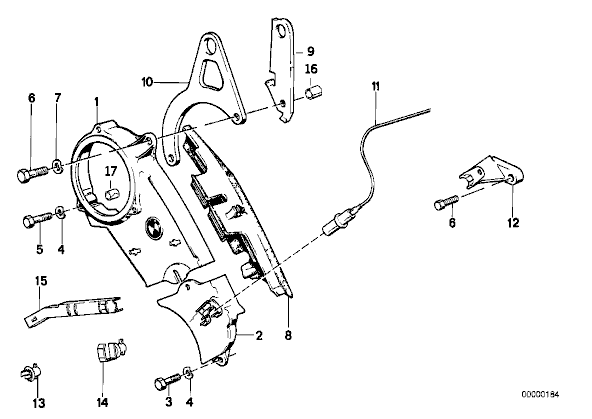

    I'm picking up an M20B25 engine/5-speed tranny to keep around as a spare. The guy pulled it in favor of an M50 swap and I need to get it out of his driveway tomorrow. The pics linked above look great, but I'd like to know exactly where the chains are hooked/looped at the front and rear of the engine and if I need to pull the tranny off to move it.

        You don't need to remove the transmission.
        In the back, there is a large cast boss on the engine block, at the top, on the intake side.
        In the front there is a ~1/8" thick metal hook, shown as part number 10 in the attached diagram.
