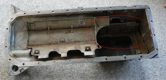

I'd like to hear some opinions on whether or not e34m50 pan is better or not in terms of preventing oil-starvation condition while high G's are acting on the car (skidpad, autox, road-course with slicks, etc)
This seems to be a problem felt by racers of m50 and us s5x cars.
here is a pic of e34 pan

and here is the stock us s50 oilpan
http://www.realoem.com/bmw/showparts...17&hg=11&fg=10
i have not analyzed both in my hands, but imo the e34 one should contain oil volume much better because of the two 'bulges' on the e36m3 on and onlu one on e34 pan
also, how would one go about bafflng our pans?
