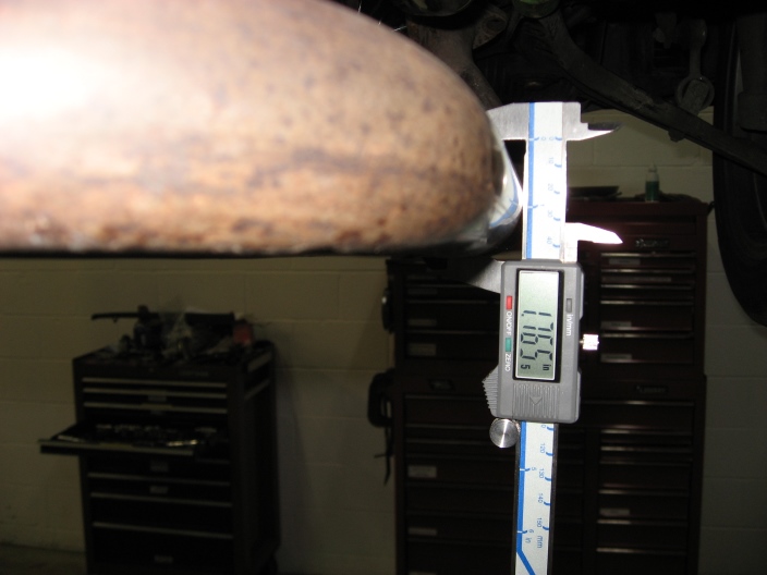

                            • dougsic
                              • Jun 2006
                              • 284
                              Originally posted by digger
                              what size do e36 m3's use with s5X?
                              Stock e36 s50 exhaust rear pipe measures 1.765 inches O.D. and the front pipe measures 1.989 inches O.D.
