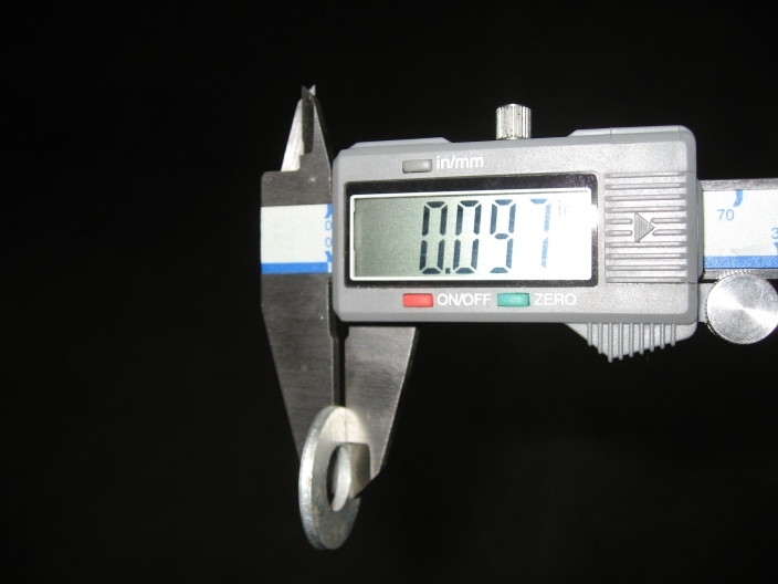

                      • dougsic
                        • Jun 2006
                        • 284
                        Just one
                        Only one spacer on the passenger side. Headers, green e28 mounts, THR cabs. The header actually cleared without a spacer at all but it was close so I used this washer.
