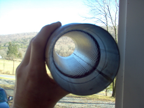

                    The 2ed muffler that you posted might as well not be a muffler at all. Or even considered a glasspack. I got two 3" ones for my Vega. I heard them on a few cars and there is very little difference between them and straight pipes! But when you pick one up and look in it your face looks like this :mrgreen:
