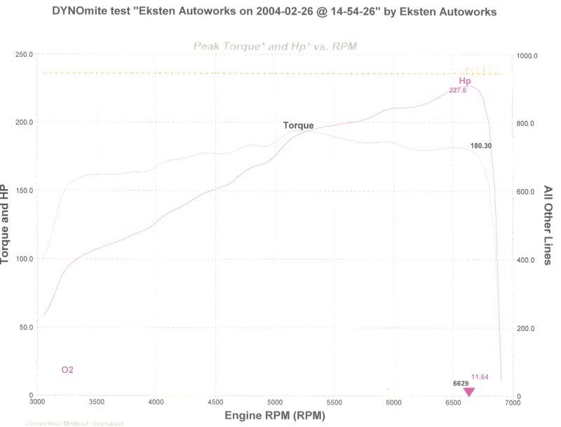

              Sorry for the grainy image, but here is the scan from my car after the intake, 3.5" HFM, and at that point "shitty stock headers/cat/Tri-Flow exhaust" setup, and appropriate Turner/Conforti chip.
              As others have mentioned, do not do crank pulley, but accessory pullies are just fine. I thought cams were a real improvement, and well worth the cost. If you're going to do them, you may as well do the 24lb injectors as well (along with appropriate software changes). I liked the Turner/Conforti tune at that point, but others may have more aggressive tunes that you may like better. I like the feel and reliability of a NA motor, but others like FI. To each his/her own.
              And that's about where most people stop, with maybe the exception of doing headers and a more free-flowing exhaust. If you want more NA, it'll cost you more than a turbo set-up, so you may want to mull that over. Good luck!
                Awesome, thanks for the info.
                Now quick question, what exact mods were on your car prior to that dyno?
                • bmw332i
                  • 229
                  Prior to that dyno was an intake, 3.5" HFM, Conforti/Turner chip, and Tri-Flow Exhaust. That's it. Now, however, is a totally different story.
                    schweet numbers then!
                    What mods are you running now and have you dyno'd since then?
                    • FredK
                      • 14759
                      278 whp. He had some headwork done, shorty headers, Ti retainers, custom exhaust worth more than 5 r3v member's cars, etc.
                      • bmw332i
                        • 229
                        For the most part, that does indeed sum it up. I don't think there's much else I can do other than stroke it and still leave it NA. I was tossing around the idea of MoTec a couple years ago, but lost interest because of some concerns on driveability.
