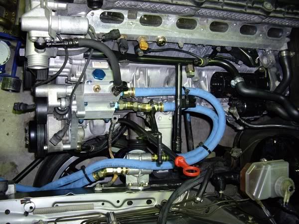

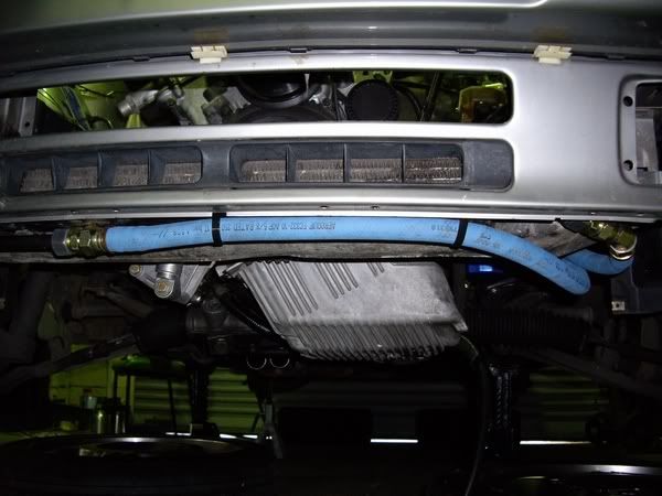

    Funny you should ask...I've just finished doing it with the VAC billet housing (expensive, but solved a few other problems for me):
    Originally posted by From my M52 swap write up
    Alrighty...the oil system.
    I'm running all -10 (5/8" ID) aeroquip oil hose (rated to 150oC) with push-on fittings. We decided on a single circuit, incorporating a remote mounted Z9 spin-on oil filter and the OEM E30 oil cooler.
    Don't ask about the blue theme...it's completely accidental. I'd much prefer black...but everything has turned out to be blue!

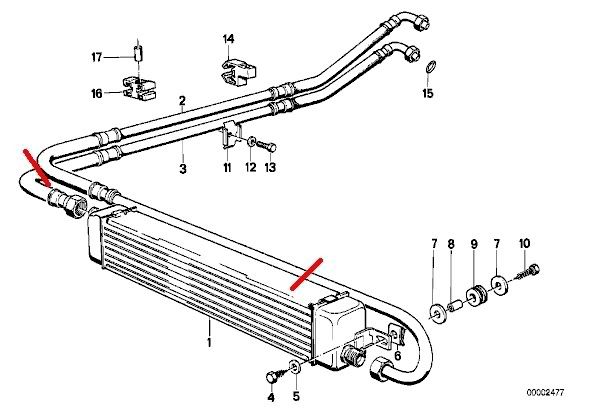

    The oil cooler took some tinkering...the OEM fittings on the oil cooler are o-ring (like aircon) fittings. So we had to keep these, then cut the hard pipes and fit 15mm olives with -10 adapters on the end. Then, because the OEM cooler is designed for the M20 (plumbed into RHS of engine) we had to swap the pipes around so we could run the hoses to the LHS of the M52:
    So we cut number 2 & 3 around about where the red lines are marked, and then swapped the two pipes around so the 180o bend headed towards the LHS of the M52. I also inverted pipe number 2 so that hose ran under the cooler...this should mean a little less obstruction of the a/c condenser.
    What I've done is one of several options...but using the euro S50 oil filter housing is common (it's a lot like the M50 housing but has provision for oil lines). I beleive there's also a billet filter cap for plumbing oil coolers...but I don't know much about it.
