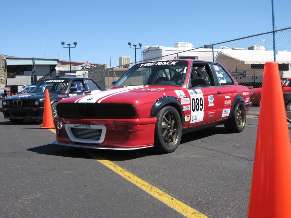

        It's tough to say. I know it probably stiffened up the cowl a little. I don't remember a huge difference. The main purpose was added safety. Even though BMW reinforced the windshield frame on the cabrios I didn't want to find out if it could support the entire weight of the car in the worse case scenario.
        I also have a race car. That car has a full cage. We had the cage buillt to prepared specs in BMWCCA club racing. We felt the difference going from no cage to cage.

          I'm running Ground Control with Koni Single Adjustment shocks, Eibach sway bars, Ground Control adjustable camber plates and Sparco upper strut brace in the front.
          Pretty much the same setup as the race car.
