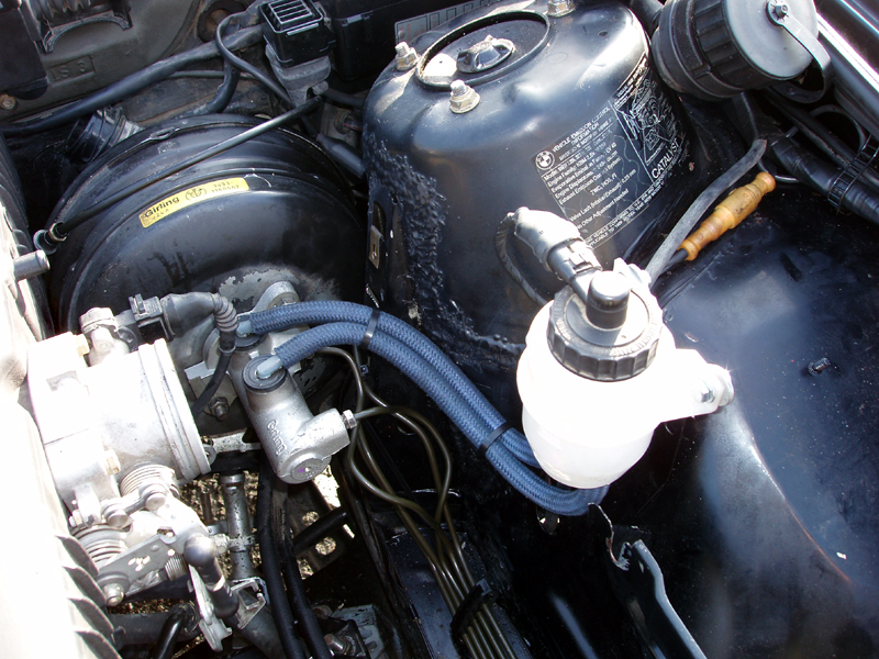

    What did you do about the resivor??
    can I cut the bracket off the back of the booster and move it back??
    The resivor is hitting my TB and causing issues with the vac lines.

      I believe that you have to relocate it with 2002 brake lines or lines from a 5 series (don't know which model specifically)..
      • MR 325
        • 37829
        I have a remote unit from a 2002.

          Whats a remote unit??
          I found this last night...
          http://www.realoem.com/bmw/showparts...34&fg=25&hl=15
          I think I got a idea so we will see if ti works out.
          if not then Im out a brake booster and will just figure something else out.
            Thats pretty much what you need :)

                      ^^ ... do away with the bracket.
                      mount the booster directly to the wall by drilling new holes in the firewall (coat with rostoleum to prevent rust)
                      measure twice, cut and weld the piece that goes to the brake pedal.
                      voila, resevoir fits right behind the intake boot. its what i did.

                        Originally posted by MR 325
                        Wow, thank you for posting that pic...
                        Is that a 2002 brake reservoir as well?
                        • MR 325
                          • 37829
                          Yes. Actually a fairly cheap part brand new too.

                            what mc r u running
                            • etxxz
                              • Feb 2006
                              • 2085
                              that's pretty friking good. i was using some 5er lines that didn't fit very well so i managed to not have to remote mount, but that is pretty simple and cheal too.
