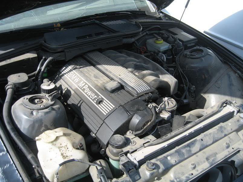

    i just need to know what i can swap from the m3 into the e30?

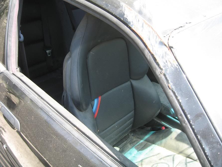

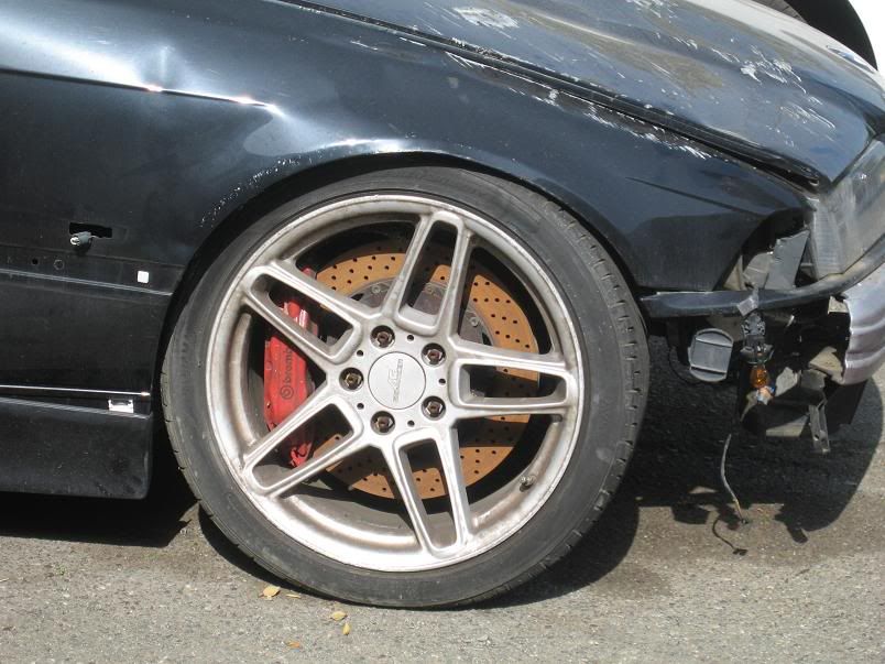

    i'll be selling the wheels and brakes because i will need to run some 16s. interior will be for sale too and the rear bumper and trunk and airbags are still good and will need to sell.
    in addition to the motor and transmission, what other parts can be used? driveshaft? axles?
    ecu and the m3 wiring? or does it need to be completely rewired into the e30? this car already has a dinan chip.

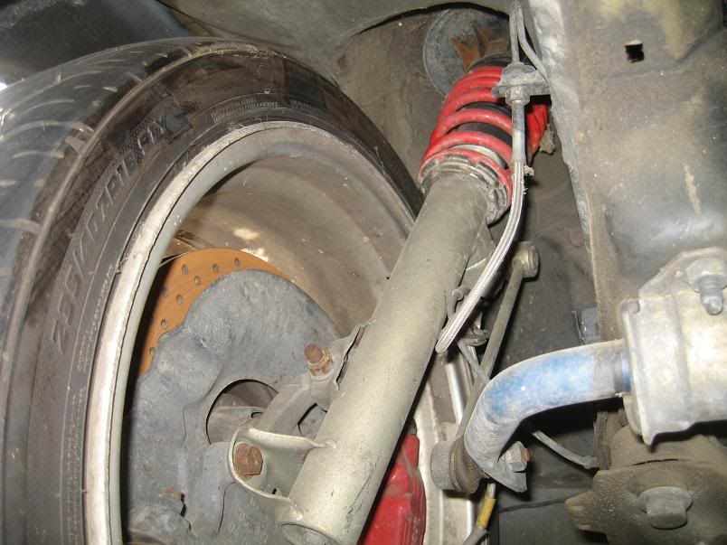

    i also want to swap the complete m3 suspension. is this possible? this car already has h&r coilovers and some aftermarket looking sway bars. can i use all this and swap the 5 lug? what needs to be modified?

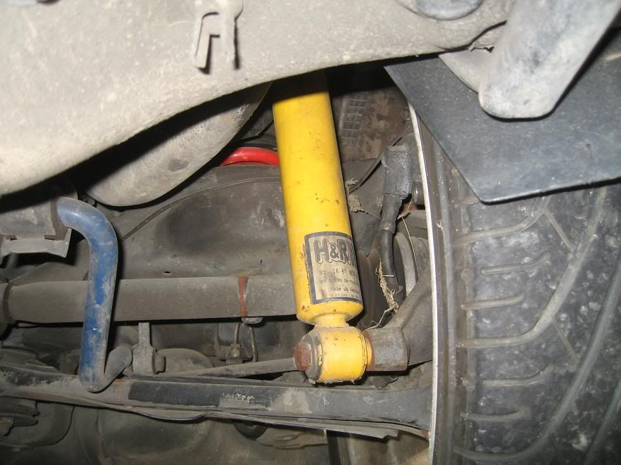

    h&r coils

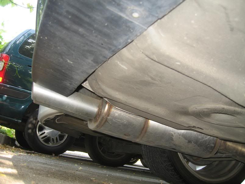

    supersprint exhaust

      Yes you can use 96+ m3 control arms, offset control arm bushings, m3 struts and get e30 camber plates made for whatever ID the coil's springs are and use those. usually you'd use e30 springs and perches but the coils change that. Nothing in back is useable. Tranny and driveshaft are useable if back of DS is 4 bolt rather than 6. Get it get it get it!

          5 lug is allong with the brakes rotors and cailipars. you going to sell that supersprint muffler? how much?

            so only the REAR shocks/springs won't swap over from the m3?
            i haven't priced everything out yet, but the muffler will most likely be for sale. pm a reasonable offer and i'll look around and see what they usually go for.

              you have everything you need in that car for:
              steering swap (use e30 OR e36 inner/outer tie rod..i have e36)
              S52 swap and run OBDII (see my wiring thread)
              -use e36 tranny/shift, driveshaft, wiring, ewsII, TR module, key, engine/tranny mounts etc d:
              Exhaust (might need to cut/weld a section but it should all bolt on
              Seats & other mist interior things.

              rear shocks idk if you can use.

                          since i'll be selling the brakes, will stock m3 brakes get the job done on a e30? maybe just drilled through for the extra cooling?
                          the rears look to be stock size, but the rotors were upgraded to drilled units.
                          do 16" wheels clear m3 brakes?
