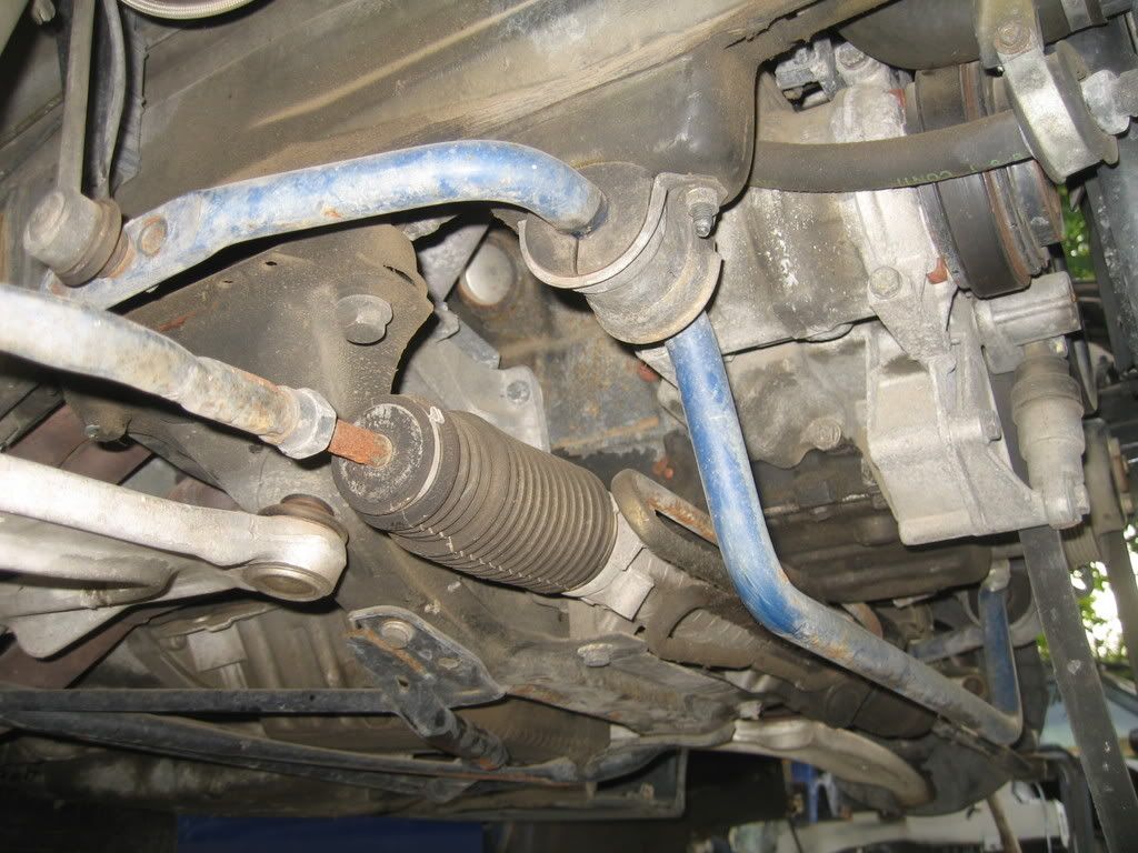

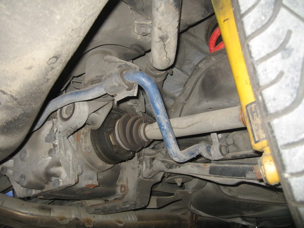

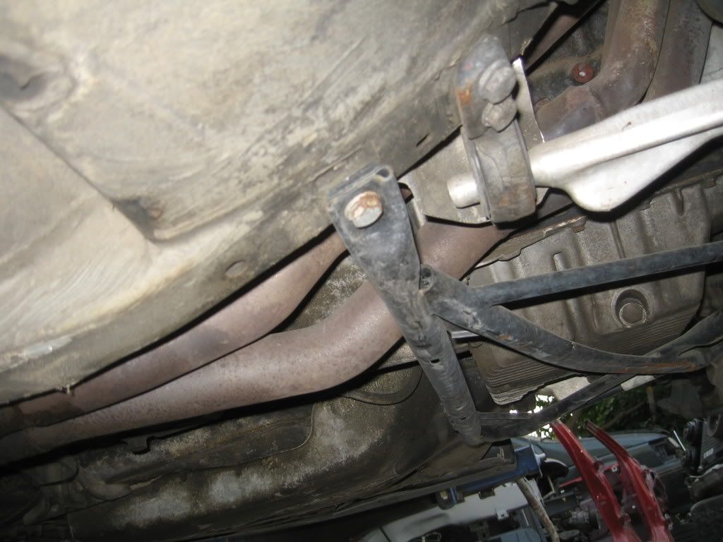

          can i use the sway bars and x brace from the e36?

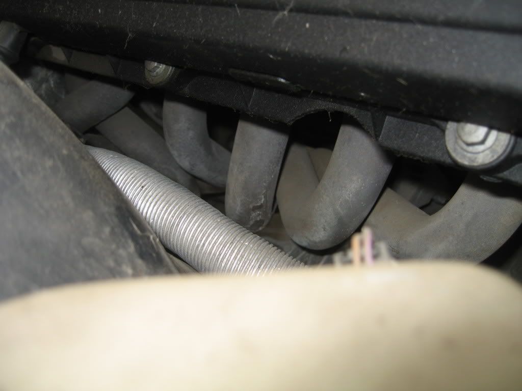

          also, is this header any good? i know its hard to tell from the pics, but maybe someone will recognize it.
          also is this xbrace oem or aftermarket?
          same question for the sway bars.

            The chasis is different, so the sways and stuff like that are no good to you. The x-brace is a stock part on convertibles that people stick on the coupes. It works well but it no good for an E30.
            If you plan on highway driving the car with an E36 tranny go with a 3.25 LSD. That combination is pretty close to the stock gearing in a 325 although it may be a tad bit lower.
            As for brakes you can't easily use the E36 M3 brakes on an E30, although anything is possible. You're probably better off selling some of it. I'd be interested in some of the parts as I have an E36 myself.
