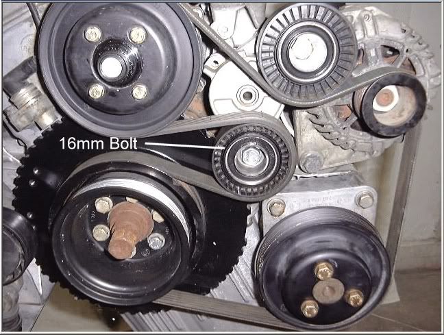

        Hopefully this helps...this is the mechanical tensioner arrangement:
        Originally posted by brandon11130
        Drew, the alternator i bought looks like yours, your tensioner pully is the strut type correct? if it is than i think im good, i just need the top pully, which is 40 on realoem, which means my local bmw dealer wants 100 for it, which means im gunna have a bitch of a time finding one.
        Yeah, I have the hydraulic type. Get everything you need from BMA Parts...their prices generally match realoem.

              thank you drew that pic comfirms my theory, that style alternator goes with the mechanical tensioner
              this style alternator, goes with the hydraulic tensioner.

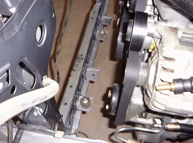

                Sorry, no. Can't find anything...I'll try and snap something of my car today...but with the rad and a/c condensor in it's a little hard to get a decent photo.
