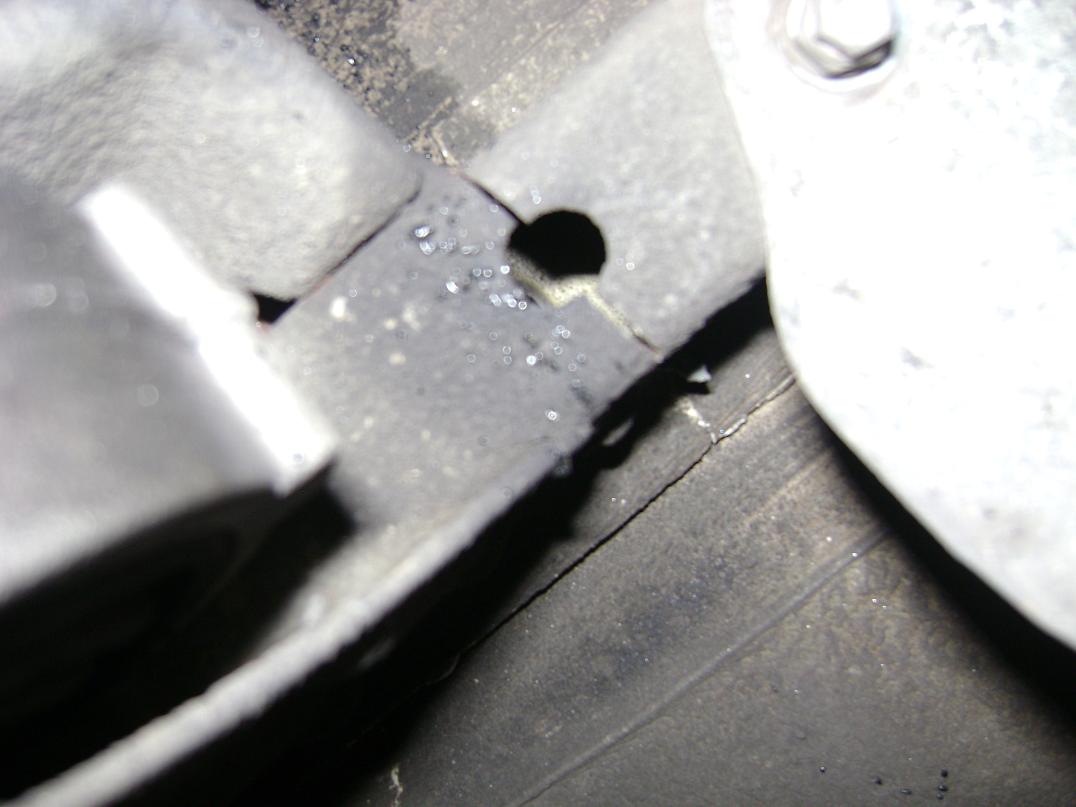

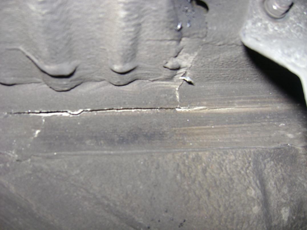

    I had the E30 in the air this morning to chase down an exhaust problem, and before putting the car back on the ground, I noticed a strange break in the undercoating near the diff mounting point.
    Upon closer inspection, it appears that a combination of a high-mileage, relatively whipped chassis and the 3.0L M50 tore the unibody at the differential pickup.
    The horizontal unibody rail that the diff ear mounts to is split (looks much like a sawzall zipped through it) and the trunk floor has separated from that unibody rail (the 4-5" separation you see).
    Now, I'm not terribly surprised to see this because the chassis has just shy of 350,000 miles and the car has been driven pretty hard in the 7 years I've owned it. I don't drop the clutch, shock the driveline, etc....but it gets doesn't exactly get driven lightly.
    Considering that I'll only be using this car for another 1-1.5yrs, the plan as of now is to wirewheel the undercoating to the bare metal and weld in some sort of reinforcement.
    I know that a similar problem occurs with the S52/S54 Mcoupe/roadsters due to the single-ear diff mount, and plan to research that this weekend.
    I've never seen this happen on an E30--has anyone else?

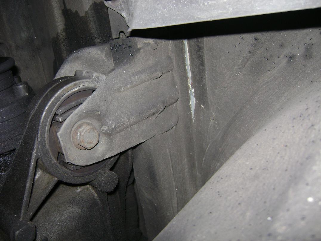

          got a question, is that a replaced diff bushing? Because i am looking at mine and it's more solid than yours. perhaps because it was replaced before, the diff moves more than it should under loads.
          Something to check out.

                        OK I've talked to a few people about the issue and it looks like the most practical solution is to clean and weld the cracked areas and then weld in a plate to triangulate the unibody rail to the trunk floor. If I were keeping this car long-term I would probably do the E36 dual-ear diff cover, but it doesn't make much sense on this car.
                        @E30serg--the 4-5" crack I was referring to is the split between the unibody rail and the trunk floor, where the rail has dropped slightly (from the split to the right of the diff ear) and separated from the trunk floor.

                        @atpyp--the diff bushing is an Mcoupe/roadster unit. I wanted a stiffer than stock one but didn't want to do urethane/delrin. Those ribs are reinforcements; it's quite a bit stiffer than the solid E30 rubber one. Whether or not that contributed to the problem I'm not sure.
