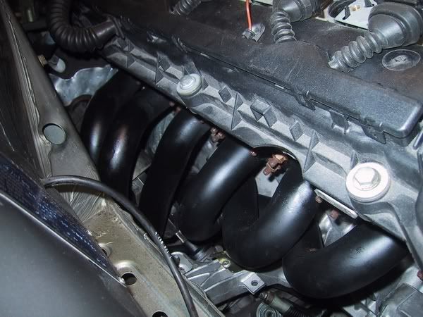

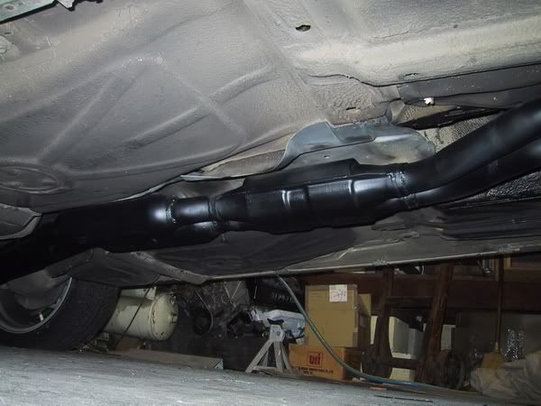

    Here's a quick run down on the current system and some pics:
    -Custom equal length extractors
    -2 x 2" mandrel bent piping
    -Cat and resonators

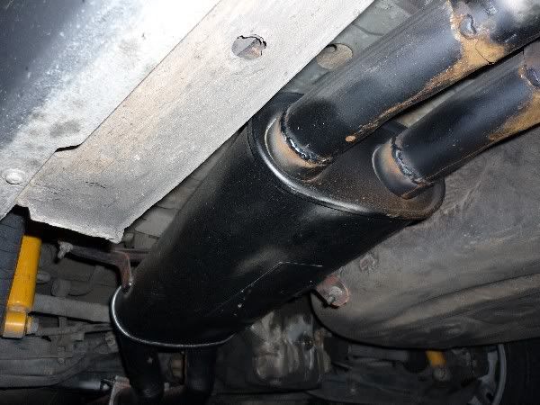

        Just some additional info...the current muffler is about 3.5"x8"x17".

          Quick photo:

            drew im running a big rear muffler and a big center muffler with a very very similar looking cat. I imagine mine would be fine NA.
            Sorry drew i more meant get rid of the hot dogs and get a center muffler instead. I have been told that the hot dog mufflers wont do a great job of silencing it due to the lack of packing
            Your rear muffler dosnt look like it would be doing much. have you taken it back to the exhaust shop you got the work done at?

                      those resonators are too small to do any good.
                      If you're muffler is straight through and you aren't too fond of it, try a dual pass muffler to quiet it down... or you could put some bigger resonators in there. the longer the better job they will do...
                      OR....
                      replace the resonators w/ a muffler and leave the rear muffler where it is. For this you could use a nice higher flowing muffler, but it will knock down the volume much more than a resonator.

                          Get rid of the resonators and use something that will "muffle" the sound....maybe like a muffler.
