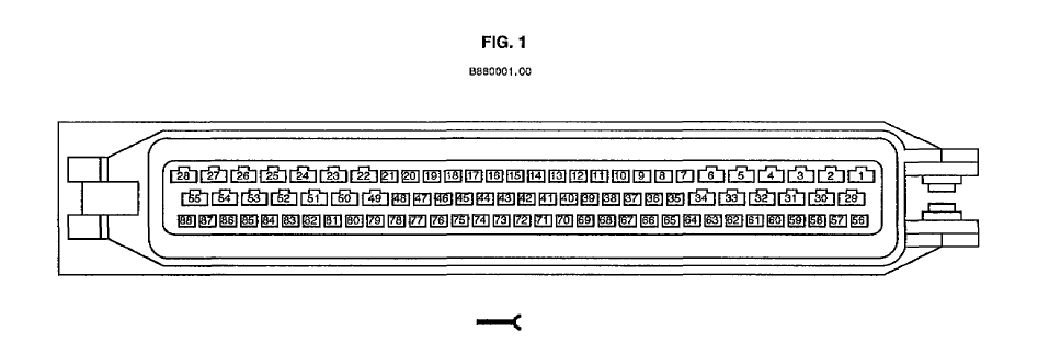

                    I see that knock sensors also need to be mounted in right order (1-3 vs 4-6) according to the manual, but both sensors use same wire colors (black and brn/org on both?).
                    o2 sensor, fuel injection valves and ignition coil wiring is clear. If I read the schematics correctly then idle speed control is (wht/grn, wht/yel, red/wht); evaporative emission valve? (grn/blue, red/wht); crankshaft position rpm sensor is blk/yel; intake air temp sensor gry/brn; tps is red/yel, brn/blk, brn; engine coolant temp sensor is brn brn/red; camshaft (hall) sensor is yel, red/wht, brn/org; hot film mass sensor is blk, gry/yel, red/wht, brn/org.
                    I don't know if the data link connector for obd diagnostics?
                    And if I need to remove 11 transmission control module (EGS) wires?
                      Using a multimeter or test light, trace the knock sensor connectors on the harness back to the DME connector, shown below.
                      Pin 69 is the Cylinder 4-6 knock sensor
                      Pin 70 is the Cylinder 1-3 knock sensor
                      Pin 71 is the ground for both knock sensors

                        Makes sense, I was thinking that's what I would have to do. I gotta find an e34 bentley and compare if the wiring is different just in case.
