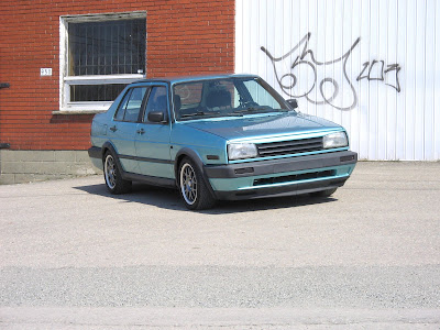

              I really want do this sawp I sure can do this. I will sure lurn a lot, but I a have a bit of mechanical experiences. Here is what I did myself on my jetta 92:
              Big front brake upgrade
              drum brake to disc brake conversion
              all the bushings
              brake lines
              headers
              head gasket
              timing belt
              clutch
              rad
              intercooler add-on (1.9td)
              Etc...
              I never swapped a car, but I feel ready for that. I know that It will be a lot of work, and I'm ready for that!
              I just wanted to know if the wiring harness (or things like that) could be cary over from 6 cyl e30 to a 6 cyl e36...
              thanks!
              and Uber E30, I will sure reed this project! thx a lot!

                      Do you mean an oil cooler? An intercooler is for a turbo.

                          he has a turbo-diesel!
