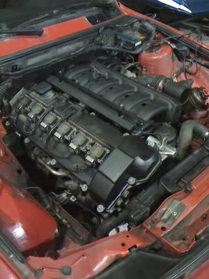

          IT RUNS!!!! i put the wire too the starter. and bought and adapter for your battery that makes the male terminal go to a end that can just bolt on the block for all the power wires. its kinda hard to explain ill post pics tomorrow. Ha all i know is after i put the key on a couple times to get fuel pressure. it started first try!

              Had the car out for a drive down the road, and i cant wait to get it done and for summer to come back. it was very fun....
              here is a pic and vid......

                  thanks man, and thanks allot for the help. I was so happy when it started right up. I'm 18 years old, and I did the hole thing with the help of you guys, the parts guy at the dealer and my girl friend.... still lots of work left to do but at least it works.... and it was very fun specially the sand on the road:)
                  just need to figure out my temp gauge then solder my wiring adapter up good and more little things.... electric fan comes in Monday more wiring to fire out, Etc

                    pics of the power wire adapter...
                    easy fix for it, it works....
