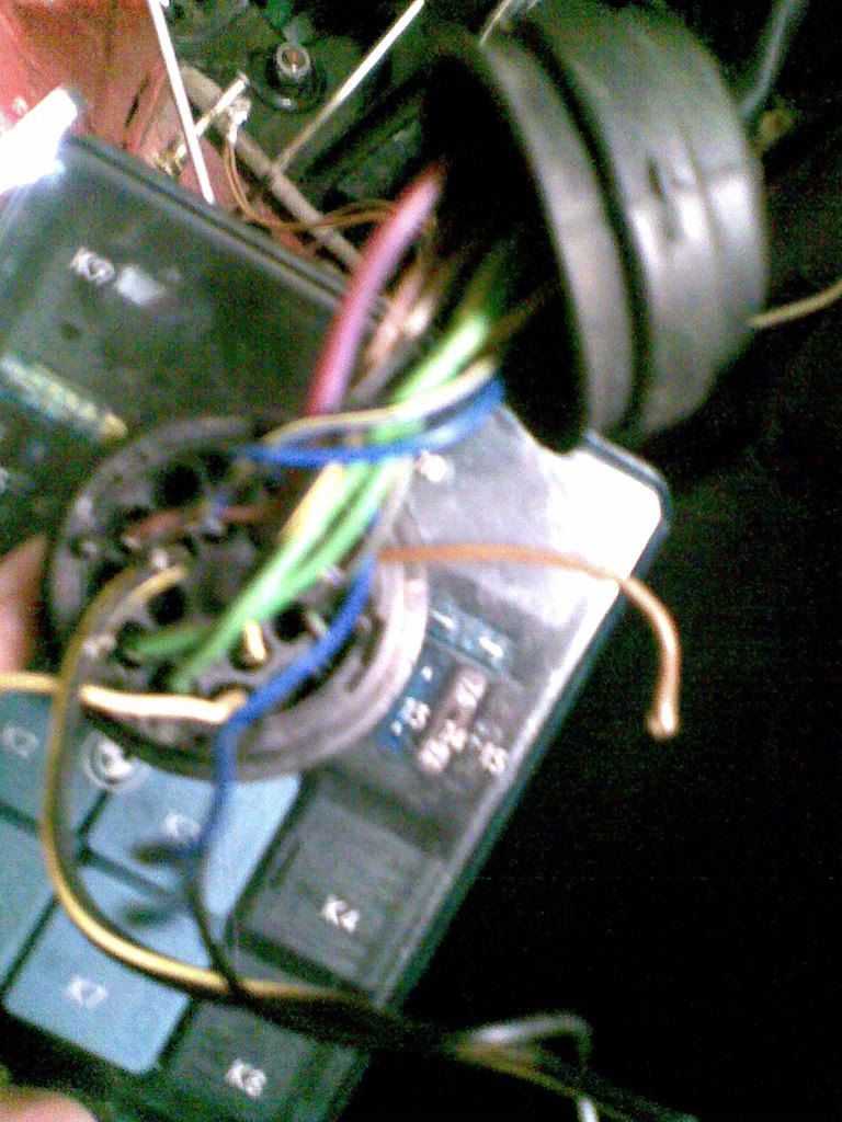

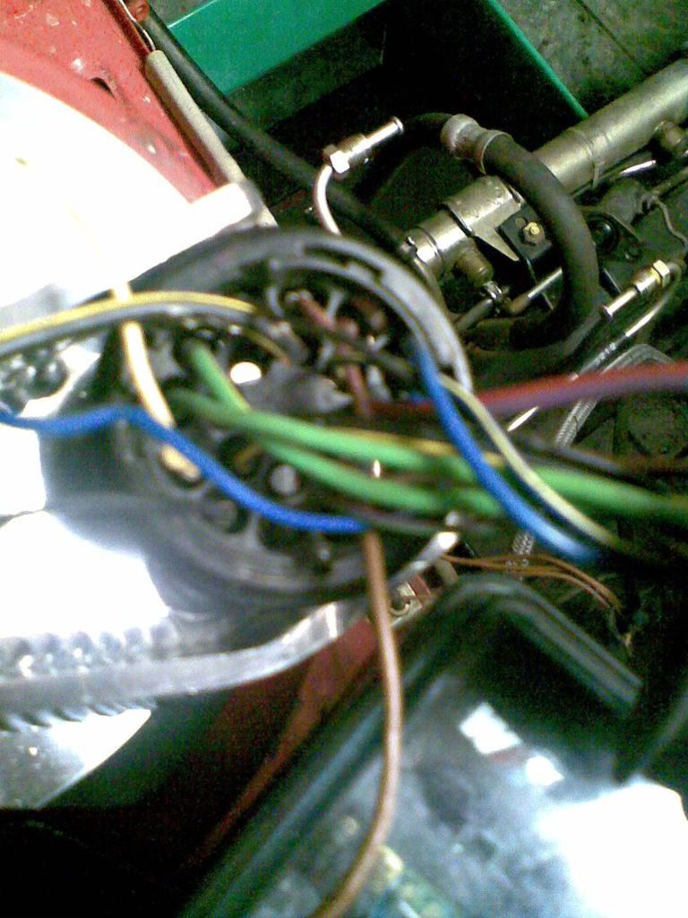

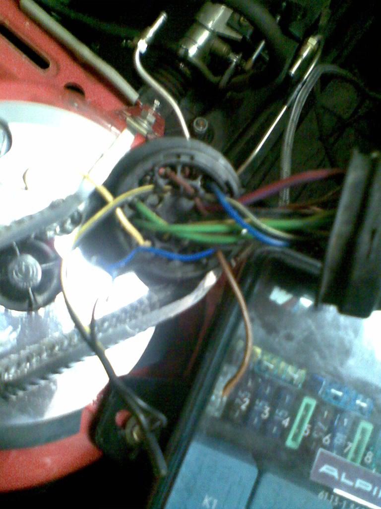

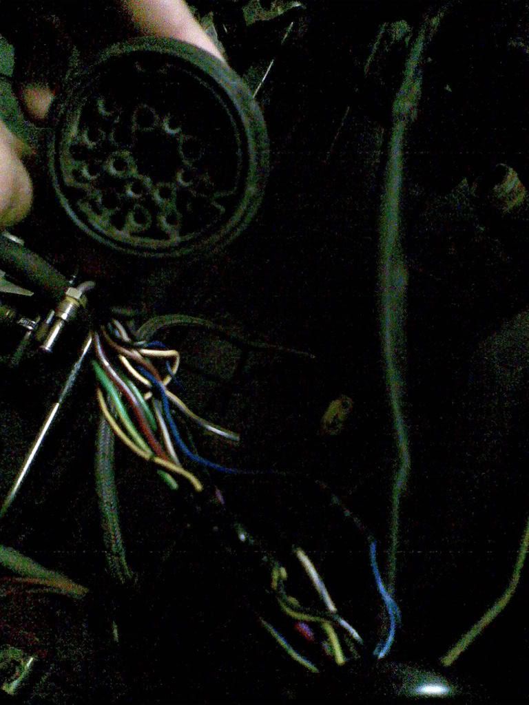

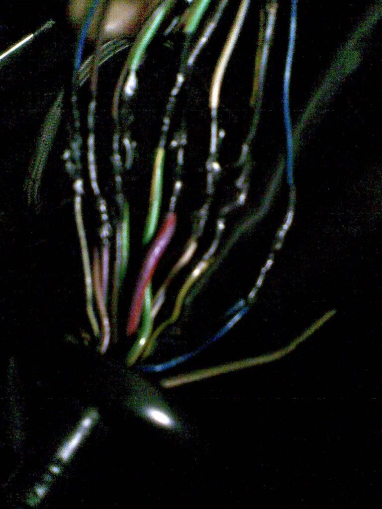

                              Here is some pics of the wiring as well as a list of what goes into where, hope somebody can help.....
                              C101 ------------------------ FUSE BOX
                              1 - BLUE ----------------------- 2X BLUE
                              2- BLUE/BLACK ------------------------ XXX
                              4- BROWN/striped ----------------------- BROWN
                              5- BLACK/BROWN ---------------------- BLACK/BROWN
                              6- GREEN/YELLOW ---------------------- GREEN/YELLOW
                              7-GREEN ---------------------- GREEN
                              8- YELLOW/WHITE ---------------------- XXX
                              9- BLACK ---------------------- XXX
                              10- PURPLE/GREEN --------------------- PURPLE/GREEN
                              11- WHITE/BLUE --------------------- WHITE/BLUE
                              12- BROWN --------------------- XXX
                              13- PURPLE/RED ---------------------- PURPLE/RED
                              14- BLUE/YELLOW ---------------------- BLUE/YELLOW
                              15- BLACK/YELLOW --------------------- XXX
                              18- BLACK/YELLOW -------------------- BLACK/YELLOW
                              20- BROWN -------------------- XXX
                              all XXX denote the wire is just loose and not connected to anything
