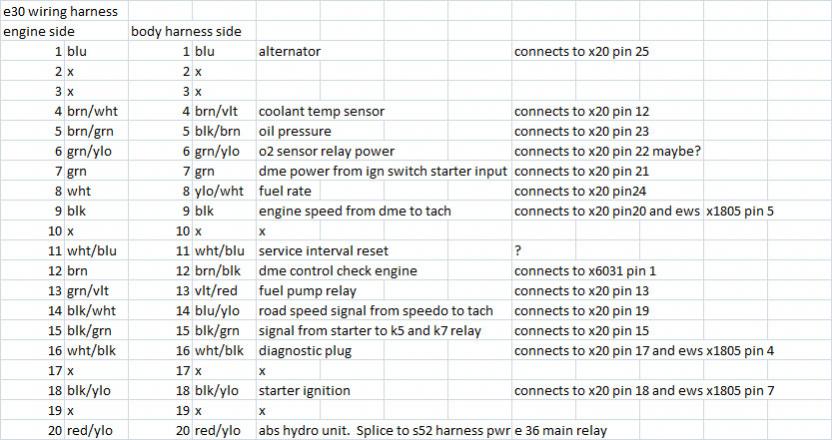

and finally, for those of you that work backwards, here is a diagram from c101 to x20
flyboyX's obd2 s52 engine swap blog
