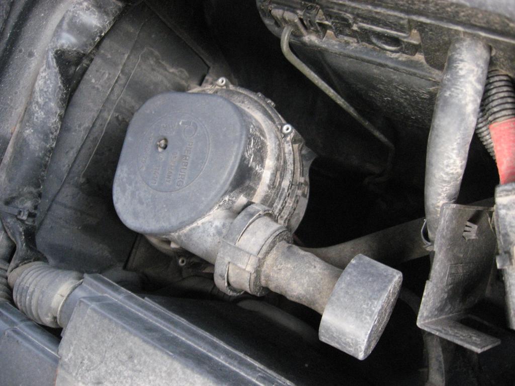

      the obd2 cars have an egr valve attached to the exhaust manifold. this valve is connectied to a hose that goes to a filtered air pump located on the passenger side next to the ecu box. below is a photo. the wiring for this air pump is located in the s52's engine harness. initially, i planned to delete this pump. i haven't seen any conversions where it was maintained. after spending sometime thinking about it, i believe i am going to relocate my convertible's battery to the trunk and mount this accessory in the battery locaton. can't seem to think of a good reason not to install it.

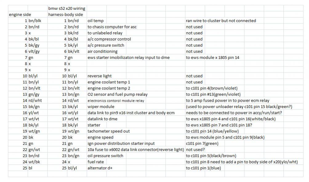

      lots of guys make a harness adapter to morf the x20 plug of the s52 engine harness to the c101 of the e30 body. i intend to use both sides of the x20 and x6031 to route my wires into the body harness. i will cut the c101 out of the e30 harness and repin or solder the wires to the body side harness plug of the e36. i think this will look a lot closer to the way it would come from the factory.

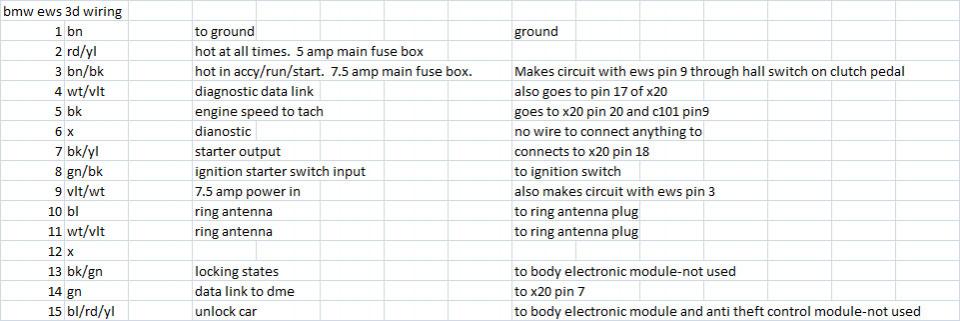

                    here is a link to some educational material for bmw's ews. it coversews 1(which is a joke) ews 2 and ews 3. there is a lot of info here here that i didn't know. it is pretty technical and not the easiest reading, but if you are going to do a swap and maintain ews2 or 3, i would say its a necessity. http://www.europeantransmissions.com...0EWS%20BMW.pdf
                    after reading through the material, i know that i have ews 3d in the mz3. it is very similar to ews2 except there is only one ews module instead of 2. also, ews 3 uses a rolling code system that changes the code every time the engine is started. apparently it is important not to attempt to start the car with either the dme or the ews module disconnected from the electrical harness. this would result in one of the modules being out of phase with the other and result in a no start. sounds like that would need to be reset at the dealer.

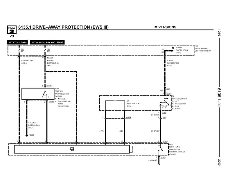

                    there really are only 2 wires that i am concerned about hooking up at this point. according to my diagram below(top left corner), pin 15 from the ews is a blue/red/yellow wire that travels to pin 10 of the "alpine anti theft module" and also pin 4 of the body electonics control module. additionally, pin 13 of the ews is a black/green wire that travels to pin 15 of the body electronics control module. these wires tell the ews if the doors are in a locked state. if the signal shows locked, then ews won't allow the car to be started. i need to figure out how to connect these the the e30 central locking system. as you can see by the diagram, those items show transisterized switches, so i don't think it should be to hard.
                    here is how the wires on the ews 3d module pin out:
                    1 terminal 31 ground (brn)
                    2 terminal 30 goes to a 5 amp fuse power in hot all times
                    3 p/n input. (manual trans) goes to hall effect switch on clutch to complete a circuit if clutch is depressed. to gnd if not.
                    7.5 amp fuse hot in accy, run, and start
                    4 diagnostic bus data link (wht/violet)
                    5 engine speed to instrument cluster engine speed (bk) to pin 20 of x20 plug
                    6 bar release code input
                    7 starter output (bk/ylo) goes through pin 18 of x 20
                    8 ign starter switch input from ign sw (gn/bk)
                    9 terminal R 7.5 amp pwr in
                    10 ring antenna (blu)
                    11 ring antenna (wht)
                    12 reserve (x)
                    13 locking states (blk/grn)
                    14 data link to dme (grn) goes through pin 7 of x 20
                    15 unlock car (bl/rd/ylo dashes)
                    as i stated above, i don't have all of these figured out yet. as i make new discoveries i will change this accordingly.

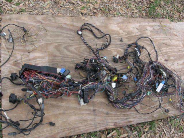

                        well, i haven't updated in a while, but here is what has been going on with my project. this is a photo of the body side of the mz3's wiring harness that i pulled out of the car. i think if you have the car and the time, this is the way to go. pictured is the body half of the x20 and also the x1805 that plugs into the ews 3d(the large white plug in the photo below). i also have a little harness for the x6031 plug as well, but you get the idea. these harnesses are going to be spliced into my e30's wiring. there is no particular reason for the length of the individual wires other than i followed them to the termination point to cut them off. there may be ten feet of wire hanging from the plug on a wire that only needs a foot, but i figure its better to take the whole thing so i can minimize the splices during the solder phase.
                        looking at the etm diagrams is one thing. however, there is no way to quantify the knowledge and associated learning you achieve by taking a cars wiring harness apart to trace/label each individual conductor. sounds cheesy, but it sort of gives you a zen of understanding about your car. i can sit here in front of my computer and type on this thread all day, but nothing will get you there like doing it yourself

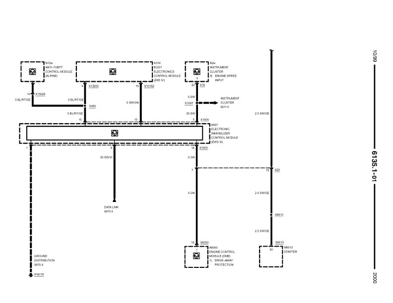

                          here are my 4 wiring diagrams that follow. this one of the x20 body harness to c101 body side harness. there is a hell of a lot of research here. please look these over closely and feel free to pick my diagrams apart if you can. any constructive criticism will be well received. revisions will be posted as they come in.
                          edit a quick edit 06 Oct 09: for those of you that have read the complete thread, you know that i have changed a few things from these diagrams. as of this date, there are about a half a dozen wiring changes i have made to make this engine run properly in my car. when i do get my swap finished and running with no check engine light fault codes, i will post a revised version of these diagrams. in the meantime, you can pm me with specific questions and i will answer them to the best of my ability. i have found that my wiring situation is quite different than all the other diagrams posted on this forum. i think these will probably only apply specifically to 99 and 00 Mz3. when i get my revisions completed, there will be many basic guidelines here that will be useful in a variety of situations.

                            this is the x6031 plug. i am thinking about splicing the few wires i intend to use from this plug into the x20(eliminate this x6031) to make the engine compartment less cluttered, but at least here is a baseline. the 15 pin x6031 is commonly used by bmw in bazillions of automatic cars as the plug to transfer wiring from the transmission to body.

                              here is the diagram for ews 3d
