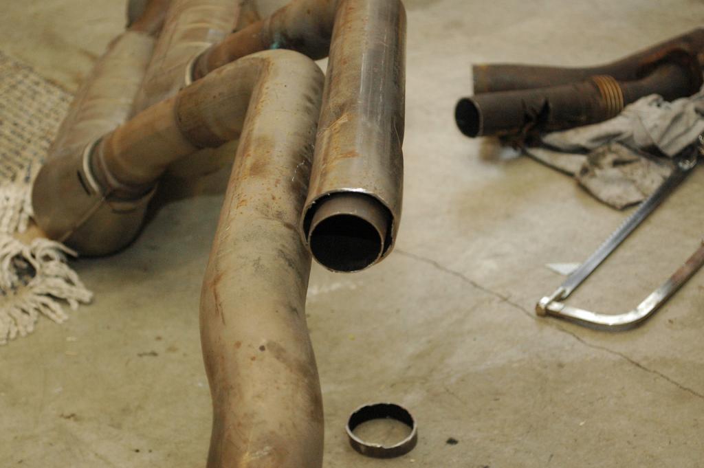

    I got a set the other day and since I don't want the Treehouse CABs I need to re-route slightly. I had a section of pipe that fit perfectly and that was relatively easy.
    First, you can see that they really have double-wall pipes. The cats weigh maybe 15 lbs more than the e30 cats because of that.
    What I thought was really interesting is that the pipe diameter on the M3 cats is actually slightly LESS than on the e30 (background) by one or two mm. I'm trusting that BMW know what it's doing here and it makes me wonder if the e30 cats are really constricting at all?
    Did BMW do this for catalyst efficiency? The M54 has the cats basically bolted to the head so this seems like an intermediate step to that.

              A hack saw? You cut through those stainless pipes with a hack saw?
              It's amazing what you've been able to accomplish - OBC correction device, M54 swap - and with so few tools.
              I have a full shop and I couldn't even get my car to start. Embarassing.
              • hoveringuy
                • Dec 2005
                • 2721
                Doug,
                The hacksaw was for something else... I cut through the pipe with my pocket knife and some dental floss. Ha ha!
                I try to be resourceful with what I have but it can take a looong time.
                i.e. I use a hose clamp as a guide to keep the cut square.

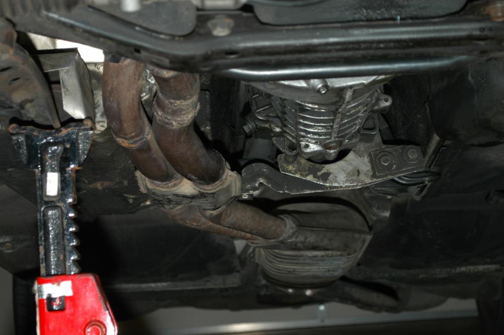

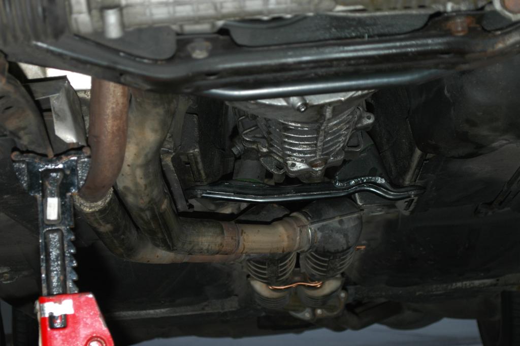

                    Before and after pics of e30 cats and OBD2 cats. This is with stock CAB's; I re-routed to avoid the CAB otherwise pipes would have fit fine with the Treehouse CAB's. Some say that the pipes will also clear the sway bar without modification but I needed to remove 1/2" of pipe from the exhaust flange area to move them up a little.
                    I still need to fabricate the hangar for the mid pipe, I'm using a copper plumbing strap now.
                    I also had a chance to take some logs on my LM-2 wideband and I found that my A/F ratios went from UNACCEPTABLY LEAN at WOT and higher RPM's to ALMOST PERFECT! Yeah!
