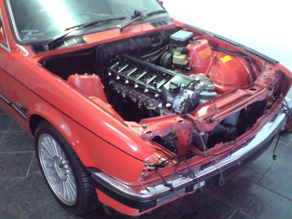

My swap - M20 to S50

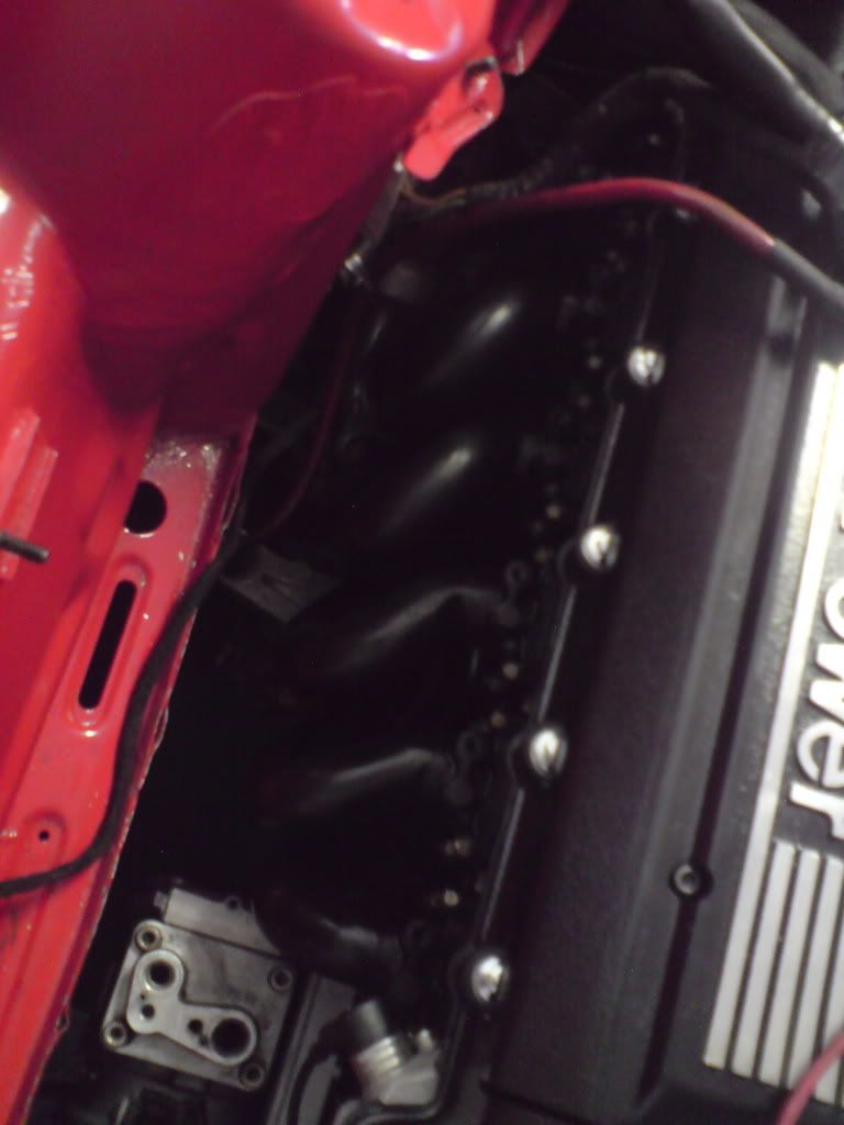

Got the branch manifold done, i used the standard M3 branches but had the last pipe modified to clear the steering column
wow euro s50 with euro bumpers... nice i wish we could easily find all that stuff around here1991 318is nv m50 : brilliantrotComment
Finally......
all put together and waiting to be driven, started her up but seems to be a miss fire.... traced it down to the MAF, gonna have to source another one....
gear lever still touching the driveshaft,have to bend that...
The getrag 260 which i installed is making a noise, whining and knocking,gonna have to strip it, got hold of a ///M 3 ZF trannyComment

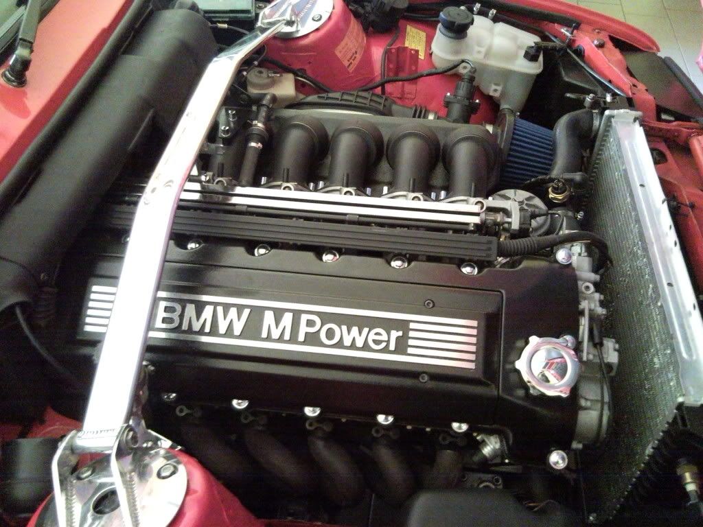

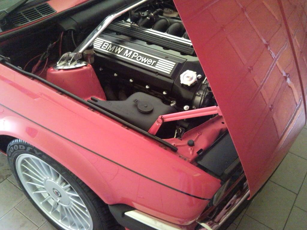

Just an update of an ALMOST complete swap, did 1700km of running in so far, feels strong but got to sort out some tuning issues first, yet to do the first oil change but decided to do it at 2000km......check the pics ....
ALMOST DONE :p
