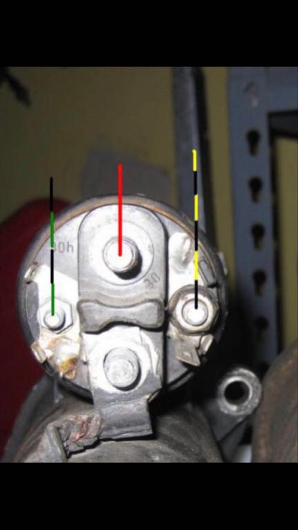

        I've always found this diagram of the starter very helpful:
        red should be hot from the battery, direct line. Green/black is unloader relay for later model cars. Yellow/black is starter/key on solenoid. to quickly test, just jump the yellow black terminal to the red terminal. This should work as long as the starter is grounded directly or the engine is grounded to the power source.
