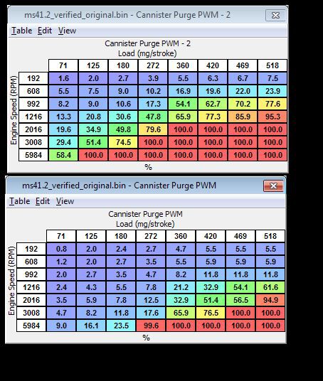

      At the risk of giving too much information and making this way more confusing, here's what I've gathered about the charcoal cannister purge logic:
      The attached pic is from ba114 years ago when he found the tables to repurpose for boost control in this thread
      The values in the cells are PWM Duty Cycle that the ECU is pulsing the valve,
      I think the x axis is TPS % and the Y axis is either Load or MAF, but you can get a general idea of what sort of conditions the valve is opening more vs less.
      Also I think these tables do not apply when:
      Engine stopped
      Engine starting
      Engine in post start
      so TL;DR is, don't bother trying to look at valve behaviour with the engine running or looking at whether you see a GND through the ECU
        Engine stopped
        Engine starting
