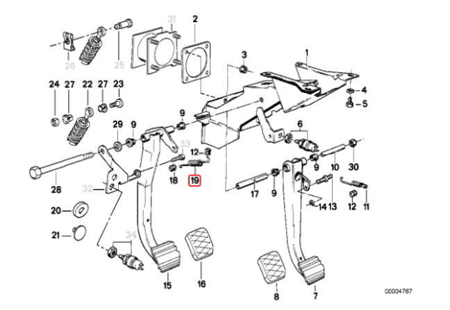

          Now, a new issue is clutch pedal randomly sticks to the floor, along with a weird high engine idle and spongy brake pedal feel haha.
            The clutch pedal should have a spring (#19) that helps assist it back up. Does yours have that?
