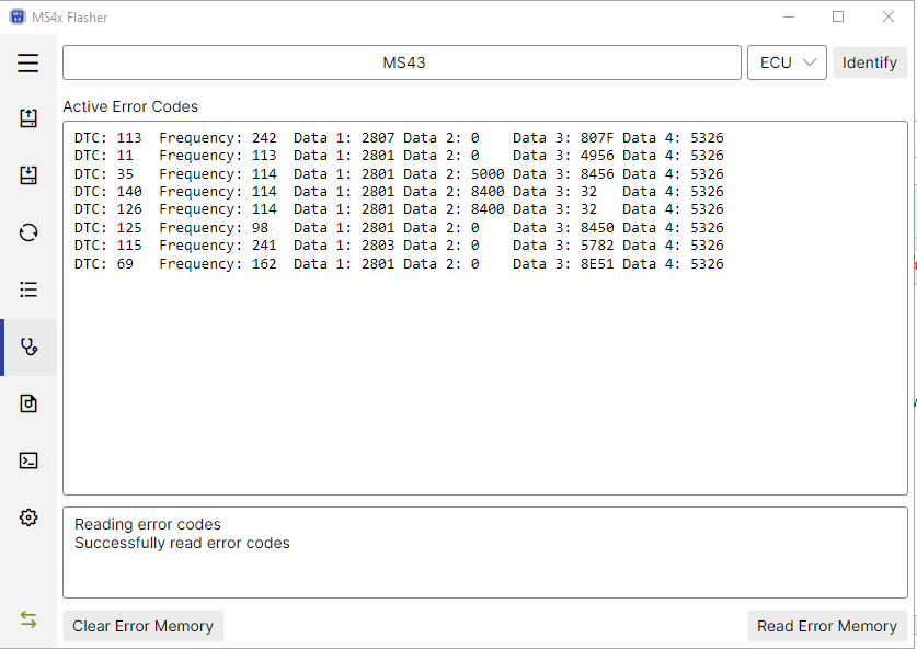

    • Using MS4x Flasher, I wrote MS430069 (with MS4x wiki's immobilizer bypass patch) onto the DME. Crank, no start. Tried it with an unaltered version of the wiki's MS43x custom firmware, which has the immobilizer bypass patch included. Same result.
    • MS4x Flasher shows me a half-dozen diagnostic codes:
    A little poking around online gave me definitions for most of these:
    • DTC 113 is motor throttle valve potentiometer. That makes sense. I swapped the throttle body for an M52 cable throttle. I realize this might also be causing problems.
    • DTC 11 is coolant temp sensor at the outlet. Makes sense; that sensor isn't plugged in any more.
    • DTC 35 is the secondary air pump. Makes sense, that got deleted.
    • DTC 140 and 126 are evap related.
    • 125 is for the cooling fan.
    • 115 is "range check for throttle position adaptation". Read above (at 113) for the throttle situation.
    • And DTC 69 is for the fuel pump relay, which makes little-to-no sense.
    Other than the throttle situation, this is a fairly basic swap, following the guide posted on this forum. I did rebuild the VANOS while I was doing everything, but I can't imagine that would have any impact.

    So for MS43, I like PASoft's BMWScanner 1.4 Go to e46fanatics.com, and it's in the pinned 'important links' thread at the top of the general forum.
    You need a piece of hardware for it from ePay or similar, but it's usually not too expensive.
    Likewise, get a dongle for INPA, and those 2 will get you through just about anything.
    The DME really wants the MDK (throttle) components to be present and working-
    if it thinks the throttle is open, or can't prove that it's closed, it won't let the engine start.
    You could test this by simply hooking up the throttle and pedal, and seeing if it starts.
    Thinking about this a little, I'm not sure MS43 is going to work without the MDK-
    it uses 'driver's wish' for quite a few calculations, and it gets that from pedal position...
    t
