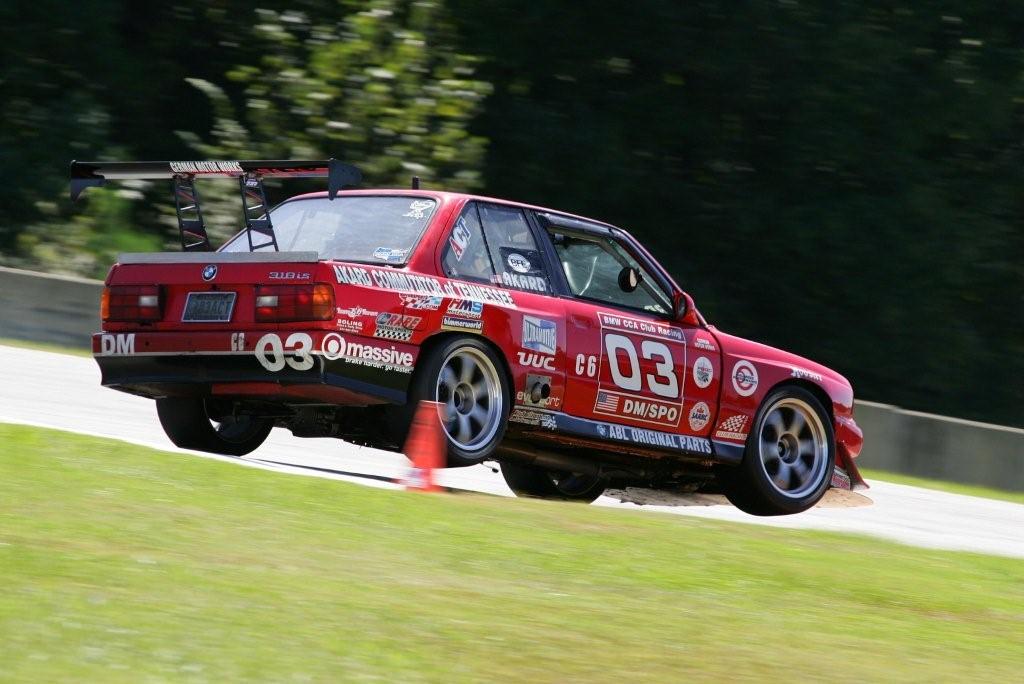

                  example...(click for full size)

                      First try and attachement or link or photos..
                      Well, if this guy, see image.... is not having oil pressure issues, I think eveyone else will be ok.
                      Was trying to show a vivid example for "case in point"
                      Alex.
                      Trying to make the world a better place, 6 TB at a time.
                      http://abloriginalparts.com/
                      • matt
                        • 3732
                        #56
                        Looks like turn 3 at Road Atlanta. Nice pic.
