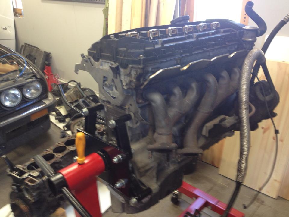

    I just towed my E30 from Dallas down to Austin where I live now. I brought an M30B34 and my M54 along with me.
    The M54 was full of water, kids kept coming by and removing the tarp that was over it... I'm still wanting to use it though, so I'll be taking it apart and seeing what needs work. The camshafts definitely need replacing, and I'm guessing the crank won't be in fantastic shape. Wouldn't be surprised if a full rebuild is in order. I like that sort of thing though, so if I can do it I will. The engine was tip top when I pulled it, would be a shame to waste it.
    Anyways, I'm finally back on this. Just thought I'd bump this up. Pic:

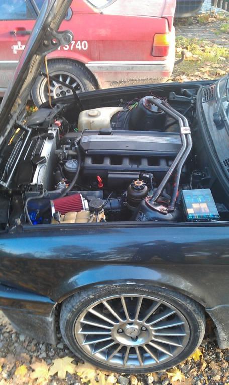

    Z3 or 5 series harness will work and be long enough for E30 application. There is a euro tune for MS42, deletes most of the emission stuff. You need body module with ews3.3 if you will keep the ews. I am working on more detailed instructions, will post it in few days.
    What does the "euro tune" mean? The engine is from a car, that was sold in Britain originally. Also the exhaust manifolds look different than in my old 330ci e46, see the pic. Maybe the car did not have secondary lambdas? I have a friend who says, he can disable the EWS from the ECU, hopefully so :) Otherwise I'll have to start thinking of other possible engine management systems.
    ps: E30 realy moves fast with M54B30, its a joy to drive it
