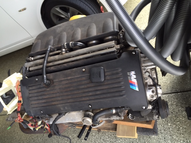

    Engine- 02 98k S54 I plan on doing bearings and I would like to update vanos, plugs, all the seals etc. Anything else?-Have
