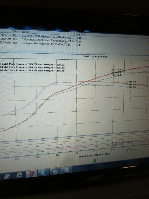

        Most s54 powered cars with single exhausts, even with the popular Bimmerworld 3.5", make pretty poor torque before 4k rpms compared to stock or free flowing dual systems. Single exhausts CAN make decent torque down low with the right headers, a WELL designed merge and GOOD tuning.
        For reference my friend is making close to record numbers on his e46 m3, has hard to get RMS long tube headers (sound and perform better than most), single 3.5" BW exhaust, the new Eventuri CAI by Evolve and custom Evolve tune - dyno'd 330whp/257wtq on 91 octane revving to only 8k. If you look at his graph, it looks like a dual system, mainly because of the headers and tune.
            I always wondered why would BMW spend more money making heavier dual exhaust system on almost all of their inline 6 cars. Now I know the reason.

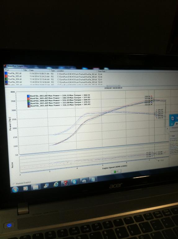

                    I hope that this graph shows well from my iphone.
                    88' E30 M3
                    2005 S54 Motor/ 5 spd ZF
                    2.93LSD
                    DINAN High-Flow Throttle Boddies
                    Stock head/cams with fresh Beisan Systems Vanos overhaul and valve adj(pump disk, seals, rattle repair kit)
                    Bimmerworld Silicone boot with ECIS Filter (e46 m3 MAF sensor housing intact)
                    VAC U/D Pulley
                    2.5 inch double piping and Magnaflow products from merge back.
                    I guess that you can assume that I am at fault for designing the merge collector/secondary too close to headers. I have the stock headers and chopped the cats. My tq down low suffers but its my rocket ship.
                    Randy's EPIC Race tune/ Stock DME standalone
                    340/277 93oct on a dynojet. Outside air temp was around 75 degrees that morning.

                      Ah yes, I was searching for your dyno sheets somewhere! You have a stock air plenum too, right?
                      • *freshm3
                        • 174
                        ^ Yes Sir.

                          Originally posted by nando
                          still stock head/bottom end other than cams? yowsers. that's like 400+hp from 3.2l.. wonder how streetable the VANOS keeps it!
                          Yes, stock head and bottom end:
                          88' E30 M3
                          2.93LSD
                          VAC U/D Pulley
                          Those have to be record torque numbers for a stock bottom end! Have you had it on any other dyno? Not saying they're not true, but IIRC 265wtq has been the max so far, and that's typically with much better headers like KromerKraft, Supersrint Stepped, Epic Race, or RMS....
