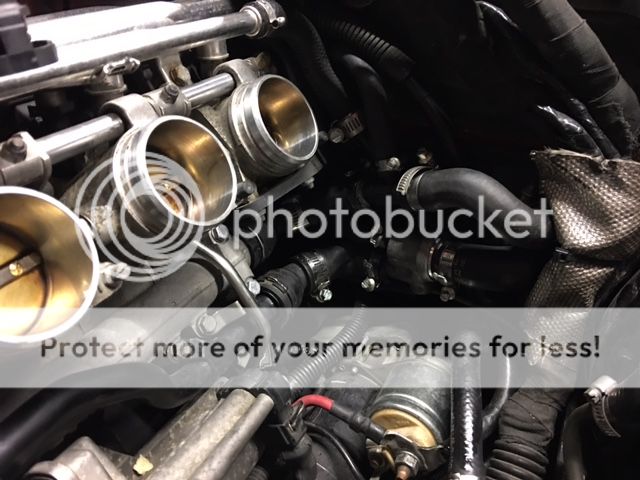

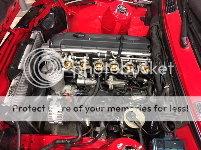

    Here are a few photos that KIND OF show other pipe routing.
    Ian Simon
