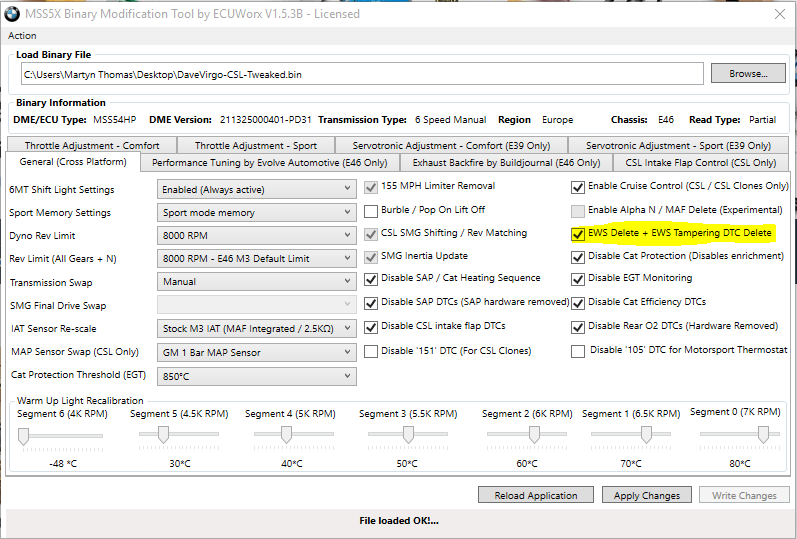

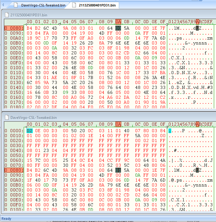

              I converted and coded the ECU for Dave, I have what I call a good knowledge of the MSS52 and MSS54. I even wrote an application to allow those with 'less' knowledge to adjust things themselves without having to delve into the hex.
              As you can see, byte 8A has been set to a non zero value, thus disabling EWS.
              With regard to the unsuppressed DTCs, I never suppress DTCs on the first flash as I like to ensure that the car starts / runs first. DTCs can then be suppressed as required, all of which I have explained to Dave. It's pointless 'blanket' suppressing DTCs as every conversion is different.
