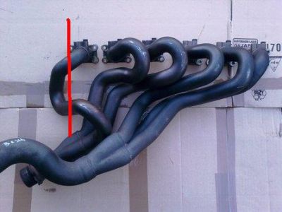

      Originally posted by Spaz
      oooohhh how much modding are you going to have to do to make that fit?!
      #6 cylinder runner will be re-routed to clear the firewall.
      subframe will be notched.
      slight re-routing to clear sway bar and lollipop.
      V-band clamps.
      +10 HP ??
          Nice, and you're still using the rest of your OBD2 exhaust?
          Yep, it will be a 100% euro M3 exhaust.
          I take that back... the euro center section must be different but it will be close.

              #246
              Let me know how those headers go! Don't leave out the details!!!
              SINdelle:E36 M3 5-Lug | 17x8 & 17x9 BBS RS | S52/ZF | 2.93LSD/3.5HFM/24lb Injectors/C&S Chip[B]SOLD[B]
              • hoveringuy
                • Dec 2005
                • 2682
                #247
                This will be step one. #6 pokes the firewall and either the firewall needs to be "adjusted" or the runner re-routed.
                I will re-route (maybe a little firewall massaging).

                  #248
                  Hmmm, I'm curious why they ran #6 like that...

                      pretty rad
                      the headers are somethin else

                          #252
                          Originally posted by Nelso235
                          pretty rad
                          Yeah, the euro headers are cool. I have them mounted in the garage like a pair of 5 point dear antlers... I have the #6 runner re-routed to clear the firewall and just got my Oxy-acetylene yesterday to help with the subframe.
                          I'll order some v-band clamps soon and maybe have them installed in a week or two.
                          Headers will push me over 220whp and a cam around 230-235.
                          I'll let anyone that's interested take it for a spin, the M54 is pretty suprising.

                              #254
                              to make it equal length?
