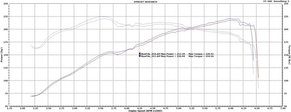

    One of the runs
    • hoveringuy
      • Dec 2005
      • 2733
      #317
      You're power curve looks much different without VANOS and DISA, but 250 torque... holly sh!t.
      Great job!
      • kariotahi
        • Sep 2007
        • 8
        #318
        Thanks Steve, yeah all the power is at the top end, but that's where it will live as a race car, it's got a M3 6 speed box so should be good.

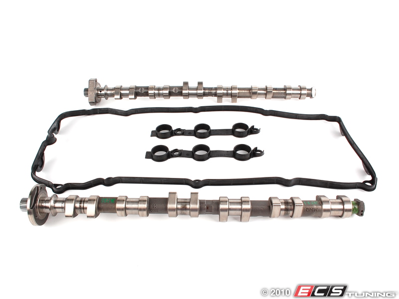

          After the last several dynos the motor just seems tapped-out and won't gain more with tuning. So, until I find an S54 I have cams on order.
          Stock M54 cams are intake 240/9.7 exhaust 244/9.0
          ZHP cams are 248/10.0 248/10.0
          They are supposed to be good for 10hp/8tq. With my mods I'm hoping for closer to 15.
          Only $299 for the whole kit at ECS tuning.

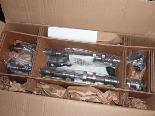

                    ZHP cams
                    ZHP cams are installed.
                    Ran into a small snag when THREE of the cam tray studs didn't hold torque on re-installation, they each had a shuffle pin associated with it. I had to pull the cams back out and helicoil. No bigee.
                    I'm getting really good at installing cams and timing the dual VANOS!
                    Car pulls noticeably harder after 4000rpm. For $299 these are a bargain.

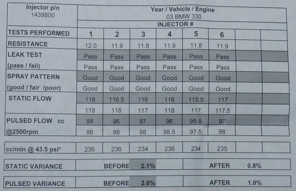

                        M54 injectors/injector flow
                        While I had the cams out I took the opportunity to send my injectors off to Witchhunter Performance. They had 100,000 miles on them and although I run a bottle of Techron through the tank occasionally, I had no idea how dirty they were. Mailed them on Monday, back on Friday.
                        I also found very little data on how much they flow, I have seen everything from 21 to 30.5 lbs. 320cc, etc.
                        Result: They were acceptably clean to start and they flow 24 lbs, best that I can tell.
                        These are Siemens DEKA injectors.
                        (BMW part#: 13537546245 Siemens part#: 1439800).
                        For reference, M50/S50 are 17lbs and M52/S52 are 21.5lbs.
                        Correct me if I'm wrong on any of this data!

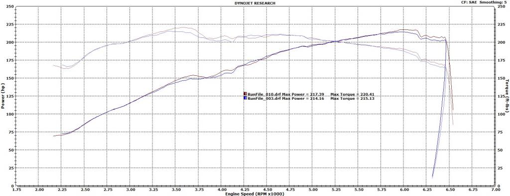

                                ZHP cam gains
                                I never did post the ZHP cam dyno...
                                First I will say the car feels quicker. The exhaust note has more bark to it and even my nephew said the car sounds different.
                                I was expecting slightly more out of the dyno, but it has the exact same tune as before and there's probably new gains to be found with tuning.
                                Also, I clearly have something going on at 6200 rpm. Most likely in the ECU since I have both cams pegged against the stops at that point.
                                This is on the same dyno, stock cams vs ZHP cams. I had a few runs with more power or more torque, but this was the best comparison.
                                Just for fun, I took the rear muffler off (dynomax turbo) leaving just the Borla center muffler:
