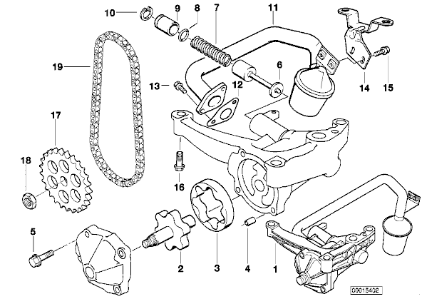

                  Anyway, I got the standard E34 oil pump and pickup tube and was messing around with that tonight when I realized the M54 oil pump is all different. Not even close. I will either need to switch in an e36 pump or fabricate a custom pickup tube. The M54 pump looks like it's got a larger capacity impeller. Anyone know for sure?
                  You be the judge... m50 vs m54 attached.

                      When I get home from work today I'll make a wire frame mock-up of the pan to see how difficult it will be to just shorten the existing pickup, give it some bends and get it in the right spot.
                      The M54 oil pump mounting flange only has one bolt, it's a different design with an O ring instead of a flange. The pickup will also need to be supported in a second place.
                      If I go with an M50 pump, I will also need to swap the sprocket and the chain. The M54 sprocet has 26 teeth; M50, 25. I could use the M54 sprocket on an M50 pump, but then it would turn 4% slower. I don't know if that would make much of a difference.
                      So, it looks like for the M54 BMW gave it larger impeller but drives it slightly slower. Could that be for double VANOS oil supply??

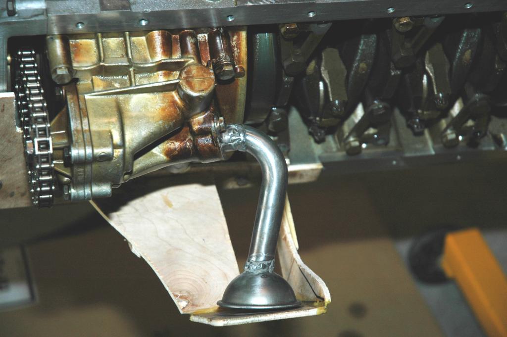

                          Fabricating the oil pickup
                          After some research I decided that I need to keep the M54 oil pump. It has higher capacity and pressure needed for the dual VANOS plus it's newer so it must be better. The E34 pickup is useless on this pump so I need to fabricate a custom one for the E34 oil pan, which will fit just fine.
                          I made a model of the oil pan using some wood. Oak. German oak harvested from the Black Forest. BMW told me to do it this way so it's Ok.
                          The original pickup had a nice 90 degree bend that I harvested and welded to the attaching flange. Cut the pipe, add the pickup bowl with the metal screen. Amost done. It's not the best welding but I've always felt that if you put enough slag on anything it will hold. Argon is on my shopping list.
                          When I get it all done I'll test fit the pan with some playdough in the bottom and see how close I am to the right clearance.
                          I'm not comfortable having the pickup held with only one bolt at the top. It's secure but acts like a resonating pendulum and I've heard about this thing called metal fatigue that makes me want to add a second point of attachment. I'll ponder that over a beer tonight.
                          I've taken the stock windage tray off and will use the one in the E34 pan exclusively. In this picture you can see the triangular re-enforcing tabs that BMW added to tie the bearing cap to the side of the motor. I guess that's a provision for the aluminum block flexing more?
                          • mattdk318i
                            • Jun 2006
                            • 3953
                            those welds concern me. But overall it looks good.
                            • PiercedE30
                              • Apr 2005
                              • 4220
                              Yea, I would have definitely TIG'd that.

                              • hoveringuy
                                • Dec 2005
                                • 2682
                                I agree, flux core wire isn't the best for this. Once I have it done I'm taking it too my buddy's house who has a Tig. It's plenty strong but ultimately the weak part is the metal tab on top so that's why I need a second attachment point.
                                Also, I forgot to mention that this motor has piston oil squirters! That's a nice unexpected bonus.
