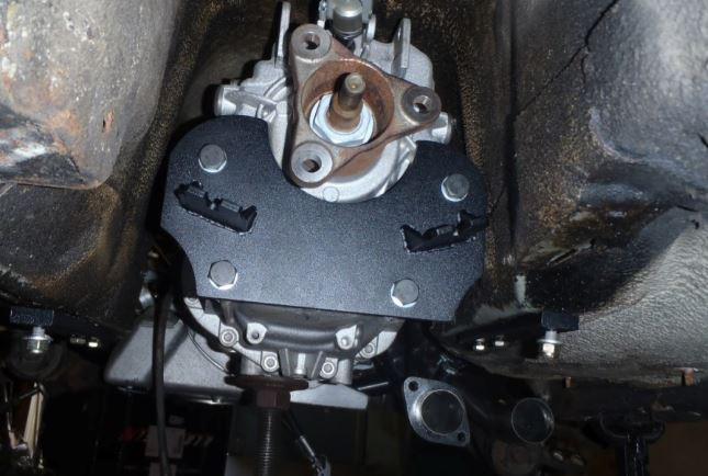

    Looking into the gearbox crossmember now. Because my gearbox is the 37dz variant it's rotated 10 degrees and its quite far back in the trans tunnel, so I have to pick up on the rear set of slides. I assume there are some factory mounts that pick up on these points, does anyone know what they'd be from? I'm struggling for inspiration but this is what I have so far:
    Your design looks just like the Kassel Performance one (and others).
    Only E46 M3 Getrag 420 transmission is supported as of 9/2023. Kit provides a turnkey mounting solution for various BMW bolt-up transmissions for E30 swaps available for a variety of transmissions including: E46 M3 6-speed (Getrag 420G), E46 330i ZHP 6-speed(ZF GS6-37),E46 330i ZHP 6-speed(ZF GS6-37), E90/E60 6-speed (ZF 6HP26);  Includes ALL necessary hardware to make mounting transmission […]
    Click image for larger version  Name:	Capture.jpg Views:	0 Size:	75.3 KB ID:	10130772
