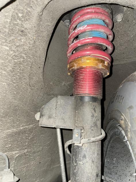

    So the whole point of shortening the housing is to gain suspension travel (when lowered). The goal is to maintain, or improve, the ride quality when you lower the car. The stock IX has like 2-2.5" of travel. That's not very much, but it's good enough for stock use.
    But when you put some H&R springs in there - you lose like 1" of that travel. As you can imagine, the remaining 1-1.5" is not great. Especially with the Bilstein HDs and their huge internal bump stops and stiff valving. You're basically using the bump stop as the spring at this point. the ride quality sucks.
    The solution is to use a shorter strut insert that matches your ride height, and of course you need to shorten the strut tube to match. But that has *nothing* to do with your ride height - aside from whatever adjuster you decided to use. That's like people who think when you change from 15" to 16" wheels your ride height changes. Your ride height is controlled by the setting of your spring perches and the length of your springs, not how much you shorten the housings.
    Of course you can shorten it too much - suspension droop is also important and is affected by using shorter struts. So obviously if you want a high ride height rally IX, you don't want to use shorter inserts (because they have less overall travel) or chop any length off your tubes. You can put height adjusters and any length springs you want on stock strut housings.
    In any case, here's my current struts as the car sits today. You can see my Chinesium Ebay height adjusters - which, amusingly, seem to be easier to adjust and less problematic than the Ground Control version. It's currently sitting on 15X7.5" ET35 wheels. I also have a set of stock IX wheels and they clear just fine (I have a set of spacers that I run mostly for looks, although they are not necessary).
    Click image for larger version  Name:	IMG_5012.jpg Views:	0 Size:	65.1 KB ID:	10055069
    There's just no way cutting the tubes will result in your tires rubbing on the struts. It has nothing to do with anything, even with the stock wheels and tires. Before this set of tires (which are stock 205/55R-15), I've run 235/50R15 and 225/50R15 on the exact same wheels and suspension. Neither rubbed on the struts.
    Also, under all the PNW road grime, admire ForcedFirebird's excellent work on the swaybar link mount. I'm pretty sure it's just box tube he cut and welded in the spot I chose (adjusting for my expected ride height and adjuster length). It doubles as the lower spring perch which was pretty clever, and I get to use the stock ix swaybar links - which, honestly, are just better than aftermarket. Unless you like replacing them every 2-3 years I guess.
    Before this setup, I had GC coilovers with stock length struts and regular ix Konis. The ride was ok, but the travel was still the same as before and you really couldn't lower it beyond what you got with H&R sports, so the height adjusters were effectively pointless. I still have those housings in the garage, I should measure them and figure out what I had cut out of the tubes I'm running now.
    But if the GC guy that messaged you says I'm just an idiot running VW shocks (I'm not) and my tires rub (they don't) and I my swabar links aren't connected (they are).. Fuck them. They must forget that I was one of their earliest IX customers, and there couldn't have been very many of us!
    Leave a comment:
